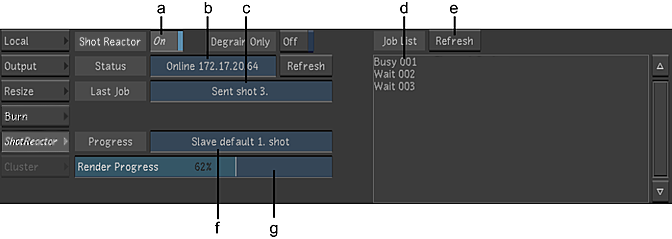

  5. Access the Render / ShotReactor menu.
    (a) ShotReactor On/Off button  (b) Status field  (c) Last Job field  (d) Job List  (e) Job List Refresh button  (f) Progress field  (g) Render progress bar  
    In the Status field, the status and IP address of the ShotReactor machine are displayed. If you are using ShotReactor locally, is displayed in the Status field. This is the default setting.
    Tip:Click Refresh to update the Status field.
  6. Set the ShotReactor On/Off button to On.
    The letters BR in the upper-left corner of the screen indicate that ShotReactor is activated.

  9. To view the render status, display the ShotReactor menu.
    The last job sent to the ShotReactor is displayed in the Last Job field. The last job sent is also the shot currently being rendered, and its name is displayed in the Progress field. The shot's render progress is indicated by the Render progress bar.
    Tip:The Render progress bar shows the shot's render progress as a percentage and updates every second. You can change the update interval using the Refresh in Seconds slider in the Network Rendering tab of the project configuration. See Network Rendering Settings.
