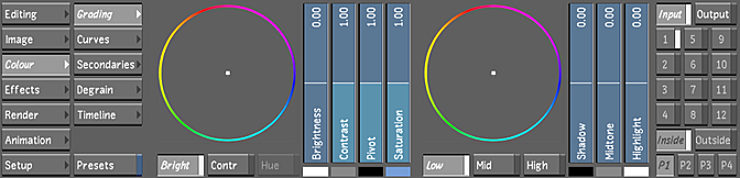

Click one of the following buttons.
Secondaries
Displays the Secondaries menu, where you have access to the geometry, keyer, presets, secondary layers, and tracker panels. See The Secondaries Menu.
Grading
Displays the Grading menu. Once geometries have been created, use the Grading menu for secondary colour grading. In Log mode, make adjustments to brightness, contrast, saturation, and hue. In Linear mode, make adjustments to lift, gain, hue, gamma, and saturation. Use logical operations to link geometries across secondaries. See Primary Colour Grading.
Note:You can also modify RGB and Hue curves for secondaries using the Curves menu. For information, see Colour Grading RGB and Hue Curves.
