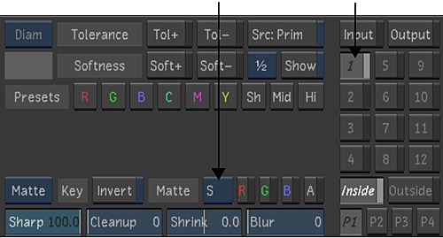

In the following screenshot, the matte on the secondary track is applied to the first secondary colour grading layer.

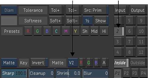

In the following screenshot, the matte on the V2 track is applied to the second secondary colour grading layer.

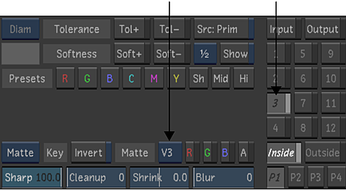

In the following screenshot, the matte on the V3 track is applied to the third secondary colour grading layer.

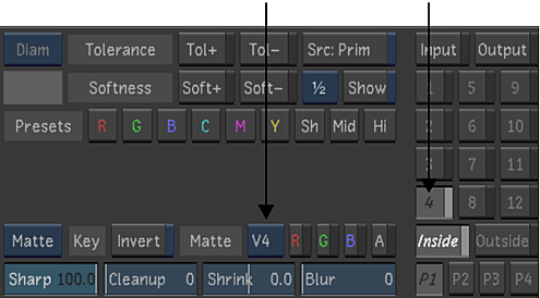

In the following screenshot, the matte on the V4 track is applied to the fourth secondary colour grading layer.
