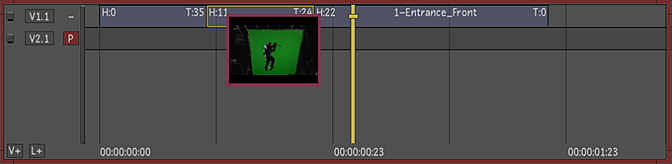

Use the hotkeys ALT+L and ALT+R to swap all shots from one stereo eye to the other on the current layer. The layer indicator will not change location. It is also possible to swap shots on all layers of the primary video track with hotkeys CTRL+ALT+L and CTRL+ALT+R.

  1. Load the Timeline you want to modify.
  2. In the Library, hold SHIFT key and select the Left clip. A "L" icon appears on the top right side of the thumbnail.
  3. Navigate the Library to find the Right clip, hold SHIFT key and select the Right clip. A "R" icon appears on the thumbnail. Release SHIFT key.
  4. Move the selection over the Storyboard or Timeline segment you want to replace and click on the thumbnail.
Both Left and Right shots have been replaced with the selection and the grading on the original shots is preserved.
