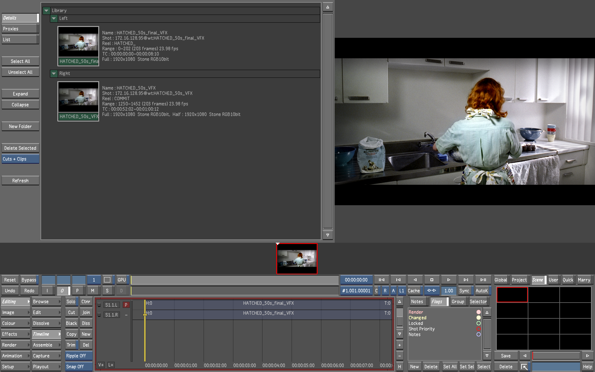

Setting Up the Stereoscopic Footage
Once you have created a Stereoscopic project, a Library with Left and Right folders, as well as a stereo timeline with a left and right layer is automatically created.
Note:The stereoscopic timeline is locked as follows:
- The top layer is the left eye.
- The bottom layer is the right eye.
To load the stereoscopic footage to the timeline:
Drag your stereoscopic footage from the folder location to the Library. See, Loading Clips to the Library.
Select and drop the footage for the Left eye into the Storyboard.
Click on the L/R button to enable the Right eye.
Select and drop the footage for the Right eye into the Storyboard.
Image courtesy of EVN PRODUCTIONS
Save the new cut. See Managing Cuts.
