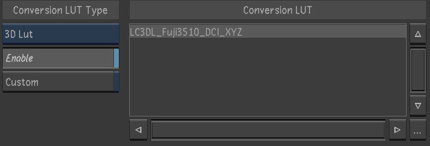

From the Transcode / LUT Options menu, you can apply a LUT or colour transform on import to Gateway-imported media. Unlike Input LUTs, the processing is performed in the Gateway rather than in Lustre.

The LUT Options menu contains the following options:
Conversion LUT Type box
Use to select the LUT Type you want to apply. Options are:
  • 1D LUT
  • 3D LUT
  • Colour Transform
Enable button
Activate to apply the selected LUT or colour transform.
Custom button
Activate to build and apply a custom colour transform. See Creating a Custom Colour Transform.
Conversion LUT list
Click to select a LUT or colour transform to apply. Click again to deselect.
This list is empty until you import LUTs or colour transforms using the Browse (...) button at the lower right. To remove an item from the list, select it and press the Delete key.
