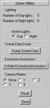

EXAMPLE
utility Infinity "Game Utilities"
group "Lighting"
label label1d "Number of Day lights:" across:2 offset:[10,0]
label label2d "0" offset:[10,0]
label label1n "Number of Night lights:" across:2 offset:[13,0]
label label2n "0" offset:[10,0]
label label3
Radiobuttons WhichOn "Active Lights:" labels:#("Day","Night")
group "Scene Data Dump"
Button scenedump "Dump Scene Data"
group "Exclusions/Inclusions"
Button DispExcl "Unhide Exclusions&Inclusions"
group "Camera Mattes"
radiobuttons CamMatte labels:#("None","1","2","3","4") columns:3
Button resetb "Reset"
createDialog infinity
The Utilities panel rollout that the previous script generates looks like the following figure.
Game Utilities rollout using group user-interface item
