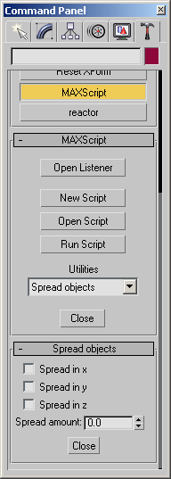

Here is a short example that implements a utility for spreading the positions of the objects in the current selection. It installs a Spread objects entry in the Utilities list. When opened, the Spread objects rollout has three check boxes and one spread amount spinner. The spread spinner event handler is called whenever the user adjusts the spinner, and the event handler expression computes a new position for the objects in the selection, testing the state of each check box to control the spread.
EXAMPLE
utility spread "Spread objects" -- define the utility name and description string ( local last_amt = 0 -- define and initialize local variable checkbox x "Spread in x" -- create 3 checkboxes checkbox y "Spread in y" checkbox z "Spread in z" spinner spread "Spread amount:" range:[-1000,1000,0] -- create a spinner on spread changed amt do -- when spinner value changes... ( delta = amt - last_amt -- calculate difference in current and previous for obj in selection do -- values for each selected object ( -- calculate new position based on current position and selection center p = obj.pos + normalize (obj.pos - selection.center) * delta if x.checked then obj.pos.x = p.x -- if checkbox x checked, apply X position if y.checked then obj.pos.y = p.y -- if checkbox y checked, apply Y position if z.checked then obj.pos.z = p.z -- if checkbox z checked, apply Z position ) last_amt = amt -- store spinner value as previous value ) -- end of "on spread changed" ) -- end of utility definition
The Utilities panel rollout created by the previous script looks like the following figure. The Close button is automatically created by MAXScript in the utility rollout, and closes the rollout.
