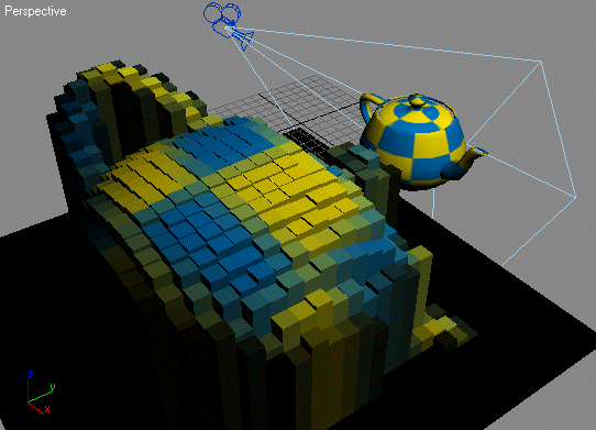

The 3ds Max scanline renderer generates a multitude of additional data channels providing information about colors, texture coordinates, normals, transparency, velocity, coverage etc. All of these channels can be accessed for reading via MAXScript.
The following simple script will render an image including Z-buffer depth info and convert it into what is known as a "voxel landscape" using the depth data to generate geometry representing the single image pixels. This script requires that geometry exists in the scene.

To run the script, simply press Ctrl+E or select Tools > Evaluate All in the Scripting Editor's menu. Make sure the current viewport shows the desired view to be rendered. The progress bar will let you know that the script is working. The result will be a group of boxes representing both color and depth of the rendered bitmap with the upper left corner at the world origin.
Where to go from here
Using this script as starting point, you could play with the creation of different object types like Spheres, Cylinders etc. A more advanced version could alter the Z position of vertices in a mesh grid based on the camera Z depth for a real heightmap elevation.
