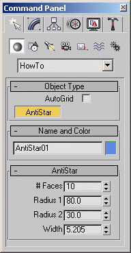

rollout params "AntiStar"
spinner num_faces "# Faces" range:[2,100,10] type:#integer
spinner radius1 "Radius 1" range:[0,10000,0]
spinner radius2 "Radius 2" range:[0,10000,0]
spinner width "Width" range:[0,90,1]
Now, you can provide the rollout with UI elements referenced by the Parameter Block. The UI elements can limit the input values using the optional range: parameter, but the default value is taken from the ParamBlock2.

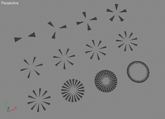

To use the plug-in, click the AntiStar button in the Create panel > Geometry > HowTo. Click in the viewport to define the center, drag to define the outer radius, click and drag again to define the inner radius, and click and drag again to define the width. Click to finish or right-click to cancel.
Play with the controls in the UI under the Modify panel and note how quickly the mesh is updated by the script.
