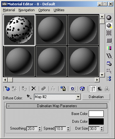

rollout params "Dalmatian Map Parameters"
This is the new UI rollout to replace the original Cellular map UI.
colorpicker color1 "Base Color" align:#right fieldwidth:48
colorpicker color2 "Dots Color" align:#right fieldwidth:48
These two color pickers are linked to the respective color parameters in the ParameterBlock2. You do not have to assign a default color here – the default value stored in the ParameterBlock2 is displayed automatically because of the internal two-directional connection between parameters and UI elements.
spinner dot_smooth "Smoothing" range:[0,100,20] \
align:#left fieldwidth:40 across:3
spinner dot_spread "Spread" range:[0,100,10] align:#center fieldwidth:40
spinner dot_size "Dot Size" range:[0,100,30] align:#right fieldwidth:40
These three spinners are also linked to the respective Floating Point parameters in the ParameterBlock2. You do not have to assign a default value here, but you need to specify the range of the value allowed by the UI – the ParameterBlock2 parameters like most internal values in 3ds Max do not have any range limitations.
Using the across:3 keyword, you can force the UI to place the three spinners in a single horizontal row.
)--end rollout
)--end plugin
Using the Script
Evaluate the script. A new Dalmatian map appears in the Material/Map browser. You can use it anywhere a regular texture map is used. The default look is like of a typical Dalmatian dog’s skin.
