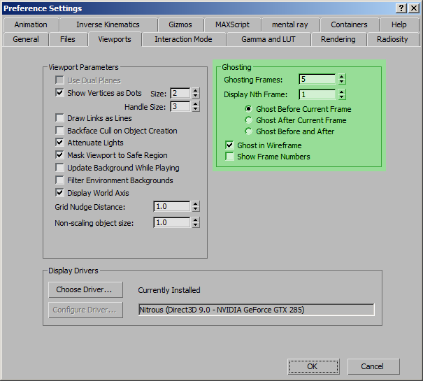

GhostingManager.DisplayGhostInWireframe : boolean : Read|Write
When set to true, the object's ghost frames will be displayed as wireframe.
When set to false, the object's ghost frames will be displayed as shaded.
Applicable only in shaded display modes.
When in wireframe display mode, both the selected object and its ghosts will be drawn as wireframe.
GhostingManager.ShowGhostFrameNumbers : boolean : Read|Write
Get/set whether to display the frame number at the pivot point of each ghost frame.
