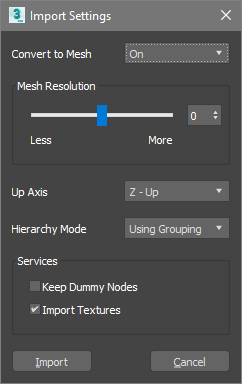

Interface: Import Settings
Properties:
ATF_Alias_importer.ConvertToMesh : boolean : Read|Write
Gets/sets the selection of the "Convert to Mesh" drop-down list.
When set to True (default), the imported geometry will be converted to a mesh.
When set to False, the geometry objects will be imported as Body_Object class instances.
ATF_Alias_importer.UpAxis : enum : Read|Write
UpAxis enums: {#x|#y|#z}
Gets/sets the selection of the "Up Axis" drop-down list.
Possible values are:
#x
: X - Up#y
: Y - Up#z
: Z - Up (default)
ATF_Alias_importer.HierarchyMode : enum : Read|Write
HierarchyMode enums: {#UsingGrouping|#UsingLayer|#Flattened}
Gets/sets the selection of the "Hierarchy Mode" drop-down list.
- #UsingGrouping (default) - creates a scene hierarchy using 3ds Max groups
- #UsingLayer - creates a scene hierarchy using 3ds Max layers
- #Flattened - creates a flat hierarchy
ATF_Alias_importer.MeshResolution : integer : Read|Write
Gets/sets the value of the "Mesh Resolution" slider / value.
Possible values range is from -10 (Less) to 10 (More).
Default is 0.
ATF_Alias_importer.KeepDummyNodes : boolean : Read|Write
Gets/sets the state of the "Keep Dummy Nodes" checkbox.
When set to True, dummy nodes will be preserved.
Default is False.
ATF_Alias_importer.ImportTextures : boolean : Read|Write
Gets or sets whether to import textures.
When set to True, textures are imported in the project's textures directory.
ATF_Alias_importer.ImportCameras : boolean : Read|Write
Gets or sets whether to import cameras.
ATF_Alias_importer.ImportHiddenObjects : boolean : Read|Write
Gets or sets whether to import hidden objects. Hidden objects remain hidden upon import. Available in 3ds Max 2021 and higher.
ATF_Alias_importer.DoubleSidedMaterials : boolean : Read|Write
Gets or sets whether to apply double-sided materials to imported faces. This will make flipped faces appear normal.
ATF_Alias_importer.PreserveLayers : boolean : Read|Write
Gets or sets whether to attempt to preserve layers. Layers can only be imported if #UsingGrouping
or #Flattened
is selected for the .HiearchyMode
property.
