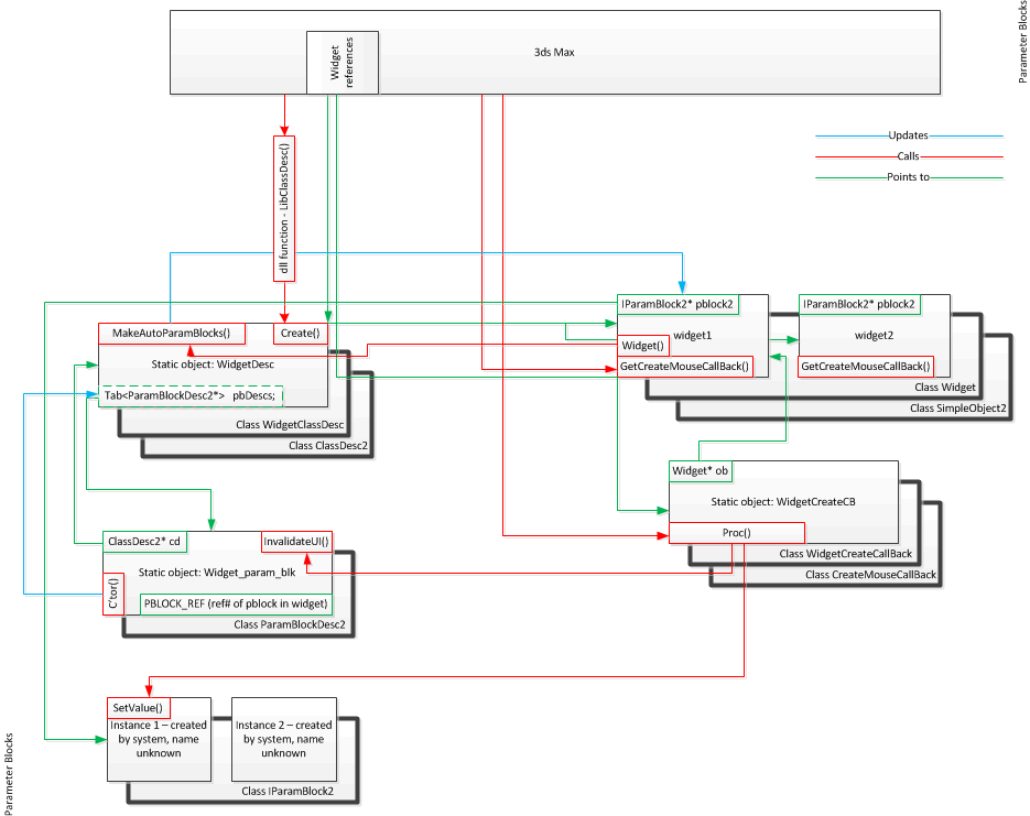

What you need to know about parameter blocks
The number of parameter blocks per plug-in, as well as the number of parameters within a parameter block is not limited. The parameter blocks in a plug-in are identified by their ID, which is usually zero for the first parameter block and increments for the next ones.
Developers do not directly call the parameter block's constructor to create the parameter blocks for their plug-in. Instead, they instantiate a static parameter block descriptor (a static object of type ParamBlockDesc2
) by passing the appropriate arguments to its constructor for each parameter block. These arguments describe the parameters that you want to include in that parameter block. The constructor of ParamBlockDesc2
automatically creates the described parameter block (an object of type IParamBlock2
) and registers the address of the newly-created parameter block in a table in the plug-in's class descriptor. The following figure demonstrates this procedure for a geometric object plug-in named Widget. The Widget plug-in project exists in the "how to" folder of the 3ds Max SDK at <3ds Max Installation folder>\maxsdk\howto\objects\widget.
