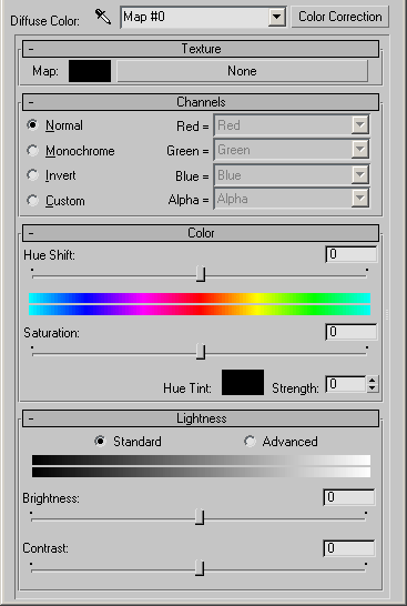

<Color_Correction>.color Color default: (color 0 0 0) -- fRGBA color; Color_1; Get/set the map's color used when no input map has been specified.
<Color_Correction>.Map UndefinedClass default: undefined -- texturemap; Get/set the input map to color-correct.
Channels Rollout
<Color_Correction>.rewireR Integer default: 0 -- integer; Get/set the Red= drop-down list index.
Possible values are:
0 - Red
1 - Green
2 - Blue
3 - Alpha
<Color_Correction>.rewireG Integer default: 1 -- integer; Get/set the Green= drop-down list index.
0 - Red
1 - Green
2 - Blue
3 - Alpha
<Color_Correction>.rewireB Integer default: 2 -- integer; Get/set the Blue= drop-down list index.
0 - Red
1 - Green
2 - Blue
3 - Alpha
<Color_Correction>.rewireA Integer default: 3 -- integer; Get/set the Alpha= drop-down list index.
0 - Red
1 - Green
2 - Blue
3 - Alpha
<Color_Correction>.rewireMode Integer default: 0 -- integer; Rewire_Mode Get/set the Rewire Mode.
0 - Normal
1 - Monochrome
2 - Invert
3 - Custom
Color Rollout
<Color_Correction>.hueShift Float default: 0.0 -- float; Get/set the Hue Shift value.
<Color_Correction>.saturation Float default: 0.0 -- float; Get/set the Saturation value.
<Color_Correction>.tint Color default: (color 0 0 0) -- fRGBA color; Hue_Tint; Get/set the Hue Tint value.
<Color_Correction>.tintStrength Float default: 0.0 -- float; Hue_Strength; Get/set the Hue Tint Strength value.

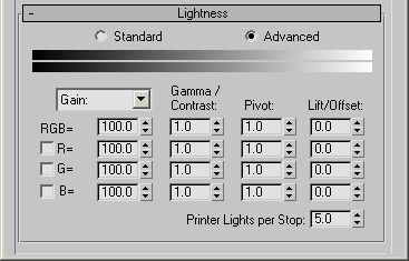

Lightness Rollout
<Color_Correction>.Lightness mode Integer default: 0 -- integer; Get/set the Lightness Mode.
Possible values are
0 - Standard
1 - Advanced
Standard Mode Controls
<Color_Correction>.brightness Float default: 0.0 -- float; Get/set the Brightness value in Standard mode.
<Color_Correction>.contrast Float default: 0.0 -- float; Get/set the Contrast value in Standard mode.
Advanced Mode Controls
<Color_Correction>.exposureMode Integer default: 0 -- integer; Lightness; Get/set theExposure Mode drop-down list's selection index.
0 - Gain
1 - F-Stops
2 - Printer Lights
<Color_Correction>.enableR BooleanClass default: false -- boolean; Get/set the state of the R checkbox in Advanced Lightness mode.
<Color_Correction>.enableG BooleanClass default: false -- boolean; Get/set the state of the G checkbox in Advanced Lightness mode.
<Color_Correction>.enableB BooleanClass default: false -- boolean; Get/set the state of the B checkbox in Advanced Lightness mode.
Gain
<Color_Correction>.gainRGB Float default: 100.0 -- float; LightnessGainRGB; Get/set the Gain RGB value in Advanced Lightness mode.
<Color_Correction>.gainR Float default: 100.0 -- float; LightnessGainR; Get/set the Gain R value in Advanced Lightness mode.
<Color_Correction>.gainG Float default: 100.0 -- float; LightnessGainG; Get/set the Gain G value in Advanced Lightness mode.
<Color_Correction>.gainB Float default: 100.0 -- float; LightnessGainB; Get/set the Gain B value in Advanced Lightness mode.
Gamma/Contrast
<Color_Correction>.gammaRGB Float default: 1.0 -- float; LightnessGammaRGB; Get/set the Gamma RGB value in Advanced Lightness mode.
<Color_Correction>.gammaR Float default: 1.0 -- float; LightnessGammaR; Get/set the Gamma R value in Advanced Lightness mode.
<Color_Correction>.gammaG Float default: 1.0 -- float; LightnessGammaG; Get/set the Gamma G value in Advanced Lightness mode.
<Color_Correction>.gammaB Float default: 1.0 -- float; LightnessGammaB; Get/set the Gamma B value in Advanced Lightness mode.
Pivot
<Color_Correction>.pivotRGB Float default: 1.0 -- float; LightnessPivotRGB; Get/set the Pivot RGB value in Advanced Lightness mode.
<Color_Correction>.pivotR Float default: 1.0 -- float; LightnessPivotR; Get/set the Pivot R value in Advanced Lightness mode.
<Color_Correction>.pivotG Float default: 1.0 -- float; LightnessPivotG; Get/set the Pivot G value in Advanced Lightness mode.
<Color_Correction>.pivotB Float default: 1.0 -- float; LightnessPivotB; Get/set the Pivot B value in Advanced Lightness mode.
Lift/Offset
<Color_Correction>.liftRGB Float default: 0.0 -- float; LightnessLiftRGB; Get/set the Lift/Offset RGB value in Advanced Lightness mode.
<Color_Correction>.liftR Float default: 0.0 -- float; LightnessLiftR; Get/set the Lift/Offset R value in Advanced Lightness mode.
<Color_Correction>.liftG Float default: 0.0 -- float; LightnessLiftG; Get/set the Lift/Offset G value in Advanced Lightness mode.
<Color_Correction>.liftB Float default: 0.0 -- float; LightnessLiftB; Get/set the Lift/Offset B value in Advanced Lightness mode.
Printer Lights
<Color_Correction>.printerLights Float default: 5.0 -- float; LightnessPrinter; Get/set the "Printer Lights Per Stop" value in Advanced Lightness mode.
