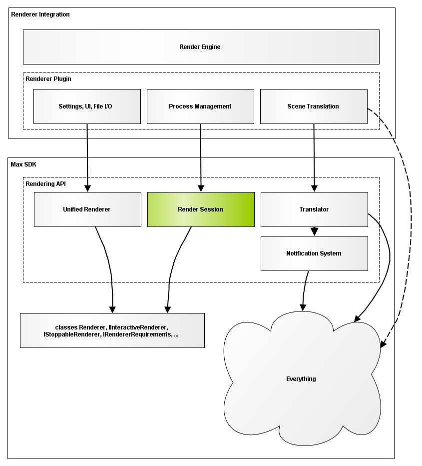

The Render Session
Whereas the Unified Renderer is the object that lives in the scene and manages user interaction, the render session is a transient object that controls the interval rendering process. It represents one running instance of the render engine - several of which may co-exist and render in parallel, for example to update the material editor preview while an interactive session is active.
The render session takes, in essence, the scene definition as input and produces a rendered image as ouput. Both of these input and output are abstracted by the Render Session Context, to be covered in a following section.

The plugin developer implements the render sessions by deriving from two interfaces: IOfflineRenderSession and IInteractiveRenderSession. As seen previously, instances of these interfaces are created using methods on class UnifiedRenderer:

Concurrent Render sessions
Render Sessions were designed with encapsulation in mind. By separating the session from the plugin, it becomes possible to have multiple render sessions exist simultaneously for a single plugin. As of today, this scheme is used to update the material editor preview while an interactive render is active. By running two sessions in parallel, we avoid having to stop and restart a render.
