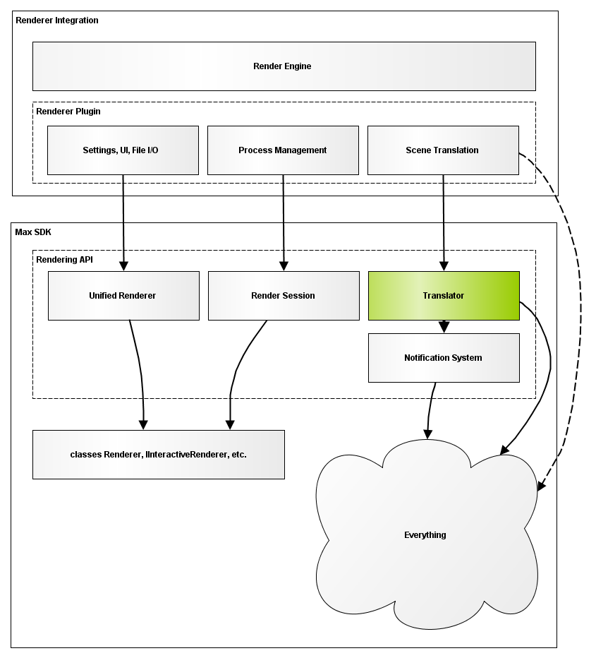

The Translator Component
The Translator Component offers a framework for building a translator upon. It facilitates scene translation and updates through its built-in mechanisms for tracking dependencies between translated elements. It also offers base classes and various helpers that take some of the translation task out of the hands of the plugin developer.
This component is entirely optional. A renderer built on top of the Rendering API does not have to use the Translator Component.
The Translator
The translation system is built on the concept of a graph of translators. The translators are responsible for translating a 3ds Max entity into the rendering engine's own representation. Thus, the translators take 3ds Max scene elements as inputs and produce the rendering engine's elements as outputs. Each translator is dependent on the output of other translators, thus forming a dependency graph.
