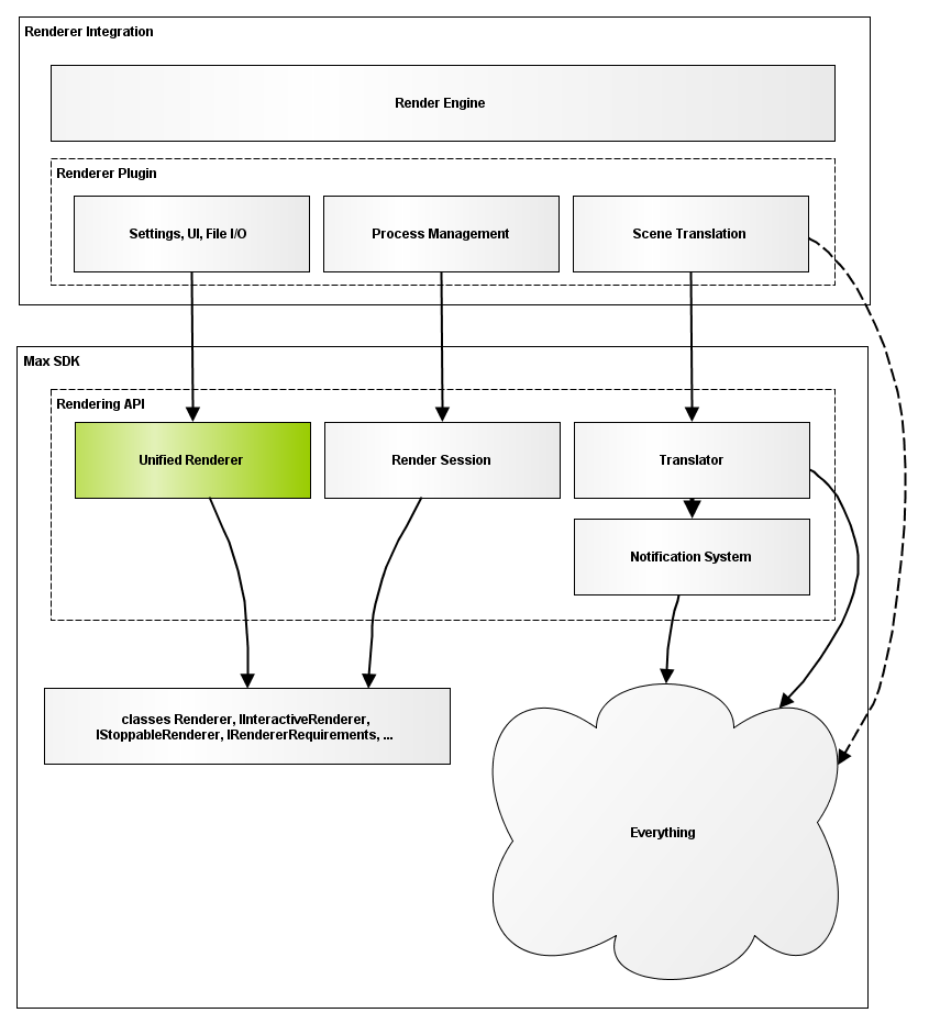

The Unified Renderer is the entry point to the renderer plugin. It is attached to and lives in the 3ds Max scene.
The Unified Renderer, implemented as class UnifiedRenderer, serves as the base class for a renderer plugin. It replaces classes Renderer and IInteractiveRenderer from the legacy API, and also integrates functionality from various extension classes. Its responsibilities are:
- It is the entry point for the renderer plugin, meaning that:
- It encapsulates the render settings (ideally through parameter blocks).
- It manages the UI for the render settings.
- It manages file I/O for the render settings (usually automatically through parameter blocks).
- It manages maxscript exposure of the render settings (usually automatically through parameter blocks).
- It publishes its set of capabilities, e.g. which material plugins are compatible with the renderer.
- It manages the creation and destruction of render session (both offline and interactive).
- It aggregated and abstracts the contents of the scene to be rendered, re-purposing the data normally passed to Renderer::Open() and Renderer::Render().
- It manages the contents of the Render Session Context (to be presented in a following section), which encapsulates all communication between the render session and the system.
