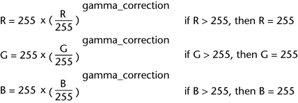

Gamma correction
Color corrects rendered images according to the following formulas. The default value is 1 (no color correction).
Note:
A higher gamma value lightens the mid-tones of the image.
