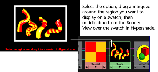

- Grab Swatch to Hypershade
Use to customize Hypershade swatches. A customized swatch lets you quickly access a scene and all its associated attributes.
