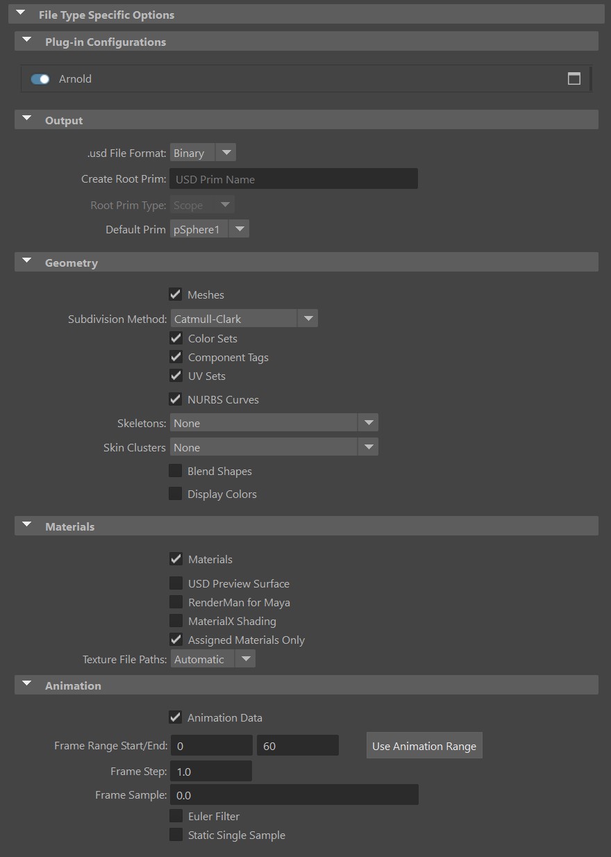

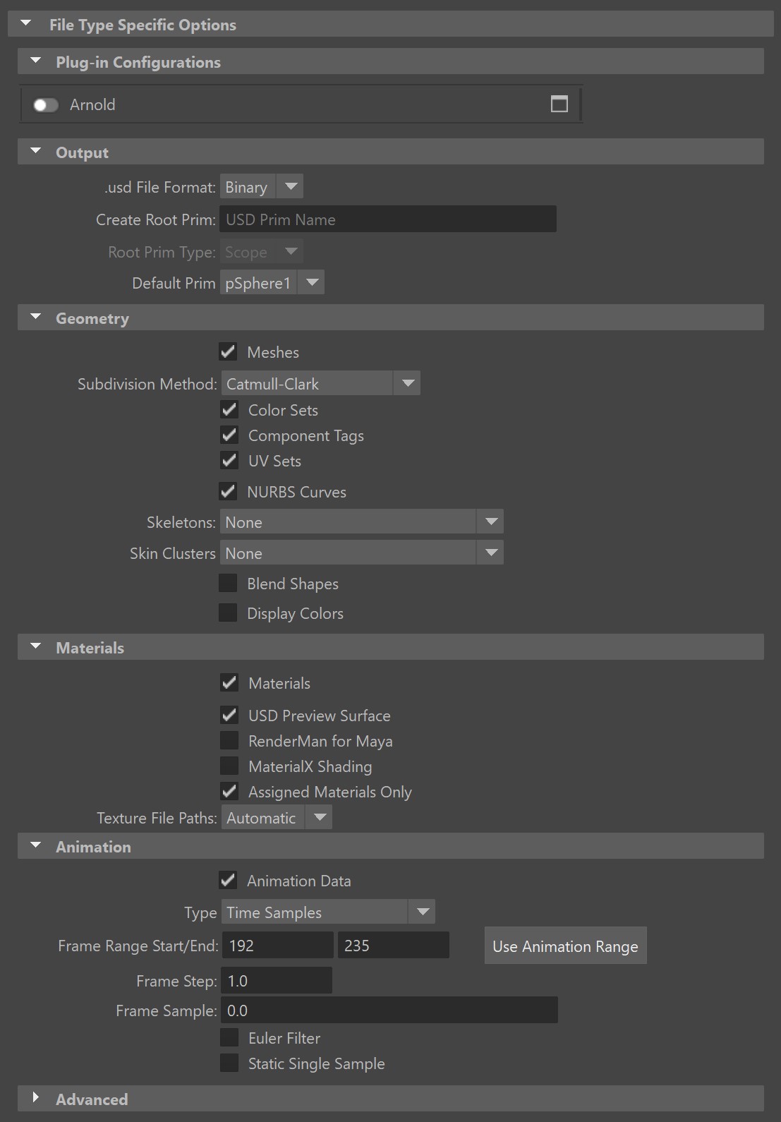

File-Type Specific Options
Plug-in Configurations
With Maya USD, you can register your plug-in and it will show up in the Plug-in Configurations section. You can easily enable/disable and configure it by clicking the options button. Visit Import and Export Plugins in Python for more information.
Output
.usd File Format
Lets you select from the following export formats:
  • Binary (Default): If you select this option, your exported file uses the file extension .usdc and is in binary format.
  • ASCII: If you select this option, your exported file uses the file extension .usda and is in ASCII format.
    Note: Manually entering a file name with an extension .usdc or .usda overrides the selection in the drop-down menu (.usdz is not supported). When a file extension is not specified, USD defaults to using the .usd extension with the binary format.
Create Root Prim
If you want to create a root prim for your exported data, enter the name of the root prim here.
Root Prim Type
Upon entering the name of the root prim, you will have the option to define the type of the prim by selecting either Scope or Xform.
Default Prim
Lets you specify the default prim.
Geometry
Meshes
If selected, mesh geometry is included in your USD export.
  • Subdivision Method: Exports the selected subdivision method as a USD uniform attribute. Attributes that are uniform appear with the "uniform" modifier in any layer that contains a properly-authored opinion for the attribute. You can select from the following options:
    • Catmull-Clark (Default): If selected, the exported file contains no additional code.
    • Bilinear: If selected, every mesh prim in the exported file is assigned the attribute uniform token subdivisionScheme = "bilinear"
    • Loop: If selected, every mesh prim in the exported file is assigned the attribute uniform token subdivisionScheme = "loop"
    • None (Polygonal Mesh): If selected, every mesh prim in the exported file is assigned the attribute uniform token subdivisionScheme = "none"
Note: Dual quaternion skinning is supported when exporting to USD.
Note: If you are familiar with scipting in USD, staticSingleSample flag is available on export, which optimizes the conversion of attributes with single time samples to static values. This is especially useful for common mesh attributes as they have the benefit of reducing the complexity of the USD, especially for USD file readers. For example, this will benefit round-tripping USD files into Maya since point-cached meshes will be able to import their UVs if they are static.
Related Concepts: See attribute and variability in the Pixar USD Glossary.
Component Tags
If selected, component tags get exported as USDGeomSubsets. Note: Edges and vertices are unsupported in USD.
NURBS Curves
If selected, curves get exported to USD primTypes NurbsCurves or BasisCurves.
Color Sets
If selected, exports Maya color sets as USD primvars. Primvar stands for "primitive variable". A primvar is a special attribute that a renderer associates with a geometric primitive, and can vary (interpolate) the value of the attribute over the surface/volume of the primitive. When this option is turned on, color sets are written out as primvars:(colorSetName) and primvars:(colorSetName):indices in the exported file.
Related Concepts: See primvars in the Pixar USD Glossary.
UV Sets
If selected, exports Maya UV Sets as USD primvars. When on, UV sets are written out as primvars:st and primvars:st:indices in the exported file. When there are multiple primvars, the index is appended to st, st1, st2, st3 etc. All UV names with custom metadata attached to the primvar can be expected to roundtrip (through import and export) seamlessly. Indexing will preserve on import and material override generation will only occur when necessary.
Skeletons
Exports Maya joints as part of a USD skeleton. By default this setting is toggled to None. If you want to enable the export of joints, choose between All (to automaticaly create SkelRoots in your USD file) or Only under SkelRoots (to have an explicit selection of SkelRoots).
Skin Clusters
Exports Maya skin clusters as part of a USD skeleton. By default this setting is toggled to None. If you want to enable the export of skin clusters, choose between All (to automaticaly create SkelRoots in your USD file) or Only under SkelRoots (to have an explicit selection of SkelRoots).
BlendShapes
If selected, exports Maya Blend Shapes as USD blendShapes. Note: This toggle requires Skeletons to be exported as well.
Display Colors
If selected, exports the diffuse color of the geometry’s bound shader as a displayColor primvar on the USD mesh.
Materials
Select the material(s) to bind to prims for export. With USD, you can bind multiple materials to prims. You can select from the following options:
  • Materials: This option is checked by default to include materials as part of the export data. Uncheck it if you want to exclude material from the export.
  • USD Preview Surface: Shading data to be extracted and mapped to a UsdPreviewSurface Maya shader node.
    Note: The UsdPreviewSurface shader node is identical to the pxrUsdPreviewSurface shader node provided by previous versions of the Maya USD plug-in. There may be backward compatibility issues with scenes that have both shader nodes loaded. For more information and a workaround, see USD Limitations in the Release Notes topic for your version of Maya USD.
    Related Concepts: For more information, see PreviewSurface in the Pixar USD documentation.
  • RenderMan for Maya: Exports the authored Maya shading networks, applying the same translations applied rfm shaders to the shader types.
  • MaterialX shading: Exports bound shaders as a MaterialX UsdShade network.
  • Assigned Materials Only: This option is checked by default to only export the materials assigned to the geometry. When unchecked, all the materials in the scene will be exported.
  • Texture File Path: Choose whether your texture file paths will be written as absolute or relative during the export process. If you select "Automatic", the path type will be automatically determined based on the current settings in the Maya data.
Note:
If you have the Maya to Hydra plug-in installed and loaded (Windows > Settings/Preferences > Plug-in Manager > mtoh.mll), you will get an additional legacy exporter which exports to UsdPreviewSurface using the mtoh codebase. This does not support phong and standardSurface and shows up as mtoh in the drop-down menu.
Texture File Paths
Choose whether your texture files are written as relative or absolute paths as you export them to USD. If you select Automatic, it will be chosen for you in the exported USD file based on what they currently are as Maya data.
Tip: If you have MayaUSD and no LookdevX loaded, it is impossible to create a texture on a prim. You need LookdevX to do this. However, if you open a USD file with a texture already authored, you can change the texture to a relative path using the file browser in the Attribute Editor. For example, you can add a texture on a rectLight or DomeLight prim relatively or even add a non-image file such as a media file on a SpacialAudio prim or a Maya file on a MayaReference prim. To do this, click on the folder icon in the Attribute Editor of a file input you want to make relative and then toggle on Make Path Relative to Edit Target Layer Directory.
Animation
Animation Data
If selected (default), animation data will be exported. The following option appears when Animation data is enabled:
  • Type: Specifies the type of animation to be exported. Options include Time Samples, Animation Curves or Both Samples and Curves. Currently the Animation Curves option supports the following attributes:
    • Camera attributes such as aperture and focal length
    • Light attributes
    • Transformations, including translation, rotation and scale
    Note:
    When using the Animation Curve option in the USD exporter, be aware that the resulting USD files may be incompatible with older versions of USD.
    • USD files exported with camera or light animation curves require USD 24.11 or later.
    • USD files exported with transform animation curves require USD 25.05 or later. Files using these features may fail to load in earlier versions.
  • Frame Range Start/End: Sets the first and last frame of animation to export.
    Tip: Click Use Animation Range to automatically populate the Frame Range Start/End fields with the scene's current frame range.
  • Frame Step: Specifies the increment between time sample frames during animation export. For example, a Frame Step value of 0.5 exports frames 1.0, 1.5, 2.0, 2.5, and so on.
  • Frame Sample: Specifies the value(s) used to multi-sample time frames during animation export. Multiple values separated by a space (-0.1 0.2) are supported. This setting can be used to help prevent interpolation errors.
  • Euler Filter: Exports the euler angle filtering that was performed in Maya.
  • Static Single Sample: Converts animated values with a single time sample to be static instead.

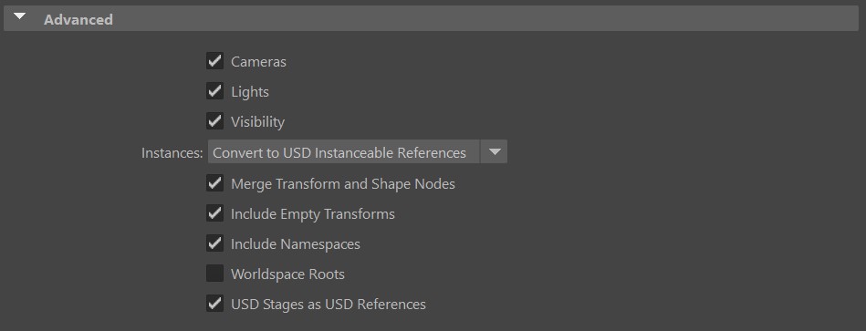

Advanced
Cameras
If selected, default cameras from your viewport are exported.
Lights
If selected, lights in your scene are exported.
Visibility
If selected (default), exports Maya's visibility attributes as USD metadata. If the object is hidden in Maya, then the following metadata is included in the export visibility = invisible.
Instances
Lets you export instances by choosing from the following options:
  • Convert to USD Instanceable References (Default): Exports Maya instances as USD instanceable references.
  • Flatten: Instances are flattened.
Merge Transform and Shape Nodes
If selected (default), merges transform and shape nodes into a single USD xform prim.
Include Empty Transforms
If selected (default), transform nodes that do not contain any child (empty transforms) will be exported into Xform prims. Deselect it to exclude empty transforms from the export.
Include Namespaces
If selected (default), namespaces are exported to the USD file in the following format: nameSpaceExample_pPlatonic1. When off, namespaces are removed from the USD file.
Worldspace Roots
If selected, exports the root prims with their worldspace transform instead of their local transform.
USD Stages as USD References
If selected (default), a Maya USD proxyShape is exported as a USD stage with a reference to the USD layer that contains the original stage.

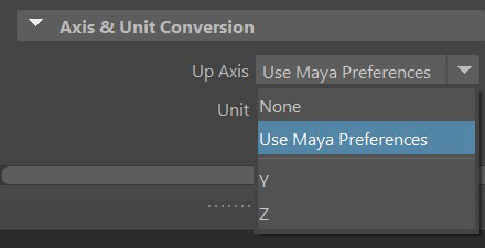

Axis & Unit Conversion
Up Axis
  • None: If selected, the exported objects will not have an Up Axis authored.
  • Use Maya Preferences: If selected, Maya's current Up Axis setting will be used to author the Up Axis for the exported objects.
  • Select a specific axis: If a specific axis is selected, an axis conversion is applied if the selected axis is different from Maya's current Up Axis setting.

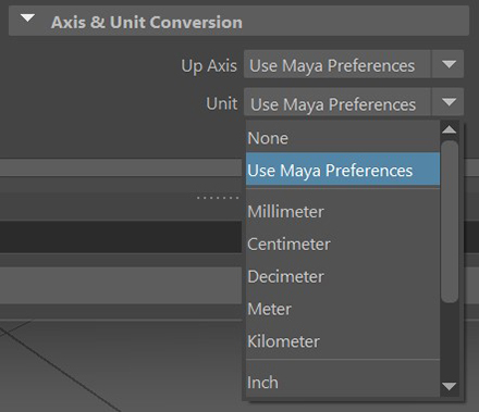

Unit
  • None: If selected, the exported objects will not be scaled, and the meterPerUnit metadata of the USD stage will not be authored.
  • Use Maya Preferences: If selected, Maya's current Unit setting will be used to scale the exported objects, and the scaling will be authored as the metersPerUnit metadata.
  • select a specific unit: If a specific unit is selected, the exported objects will be scaled to the selected unit, and the scaling will be authored as the metersPerUnit metadata.
