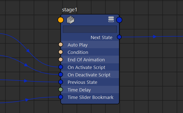

Chain stage nodes together to execute multiple Python scripts in sequence according to a set of rules. These are useful for creating interactive experiences such as tutorials or tours. For more information on using stage nodes, see Building Python state machines.
Attribute reference
- AutoPlay
- Turn this on to force playback of the current playback range when the stage is activated.
- Condition
- Turn this on to deactivate the current stage and activate the next stage (determined by Next State).
- End Of Animation
- Turn this on to deactivate the current stage and activate the next stage (determined by Next State) when the Time Slider reaches the end of the current playback range.
- On Activate Script
- The Python script to execute when this stage is activated.
- On Deactivate Script
- The Python script to execute when this stage is deactivated.
- Previous State
- The stage node preceding the current stage.
- Next State
- The stage node succeeding the current stage.
- Time Delay
- A delay (in seconds) before the current stage automatically deactivates and moves on to the next stage.
- Time Slider Bookmark
- The Time Slider Bookmark to frame when this stage is activated.
