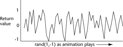

rand(-1,1)
Returns a random floating point number between -1 and 1, for example, 0.452.
If you were to execute rand(-1,1) repeatedly as an animation plays, its return values might occur as in this figure:
