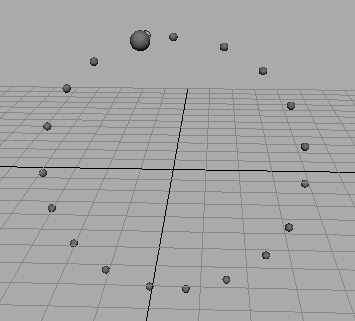

Suppose you’ve given a NURBS sphere named Planet a circular, orbiting motion in the XY plane with this expression:
Planet.tx = sin(time);
Planet.ty = cos(time);
Planet orbits the origin at a radius of 1 unit.
In the following steps, you’ll create a custom attribute named distance to increase the radius of Planet’s orbit over time.
Note:
The small balls in the preceding figure show the circular path of Planet. They’re in the figure only to help you visualize the motion. They aren’t part of the animation or expression.

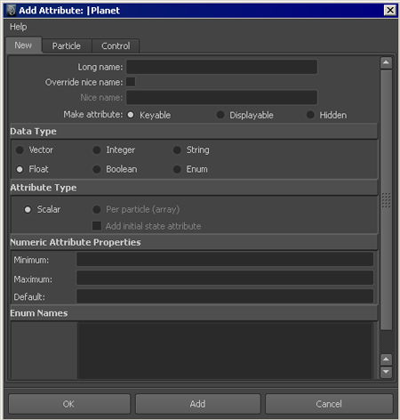

  1. Select Planet.
  2. Select Modify > Add Attribute.
  3. In the Add Attribute window, enter distance in the Long Name text box.
  4. Make sure Make attribute: Keyable is on.
  5. Set Data Type to Float, and Attribute Type to Scalar.
  6. Set Minimum to 1, Maximum to 10, and Default to 4.
    Minimum and Maximum set the lowest and highest values you can enter for the attribute in the Attribute Editor or Channel Box.
    Default sets the default value displayed for the attribute.
    An expression isn’t bound by the Minimum and Maximum values. The attribute receives whatever value you assign it in the expression.
    The expression can read the Default value or any other value you set in the Attribute Editor or Channel Box.
  7. Click Add to add the attribute, then close the Add Attribute window.
    The distance attribute appears in the Attributes list of the Expression Editor for Planet. You can now set or read the value of the attribute in any expression.

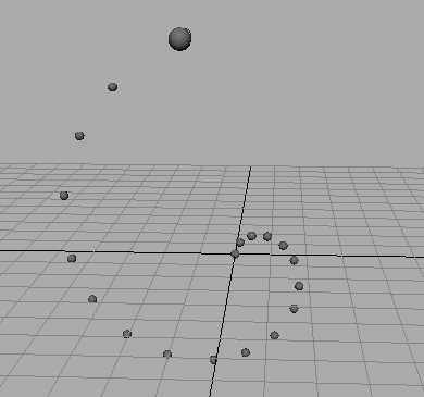

  9. Edit the expression to this:
    distance = time;
    Planet.tx = distance * sin(time);
    Planet.ty = distance * cos(time);
    By setting distance to the value of time, Planet’s orbiting distance increases as playback time increases. Planet moves in a steady outward spiral as the animation plays.
