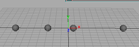

Suppose you use the rand function to position several marbles at random translateX positions in your scene at frame 1:
if (frame == 1)
marble1.tx = rand(-10,10);
marble2.tx = rand(-10,10);
marble3.tx = rand(-10,10);
marble4.tx = rand(-10,10);
The rand(-10,10) returns a random number between -10 and 10 each time it executes. When you rewind the animation to frame 1, Maya might assign these values to the translateX attributes of the marbles:
| Attribute | Value |
| marble1.tx | 2.922 |
| marble2.tx | 5.963 |
| marble3.tx | -4.819 |
| marble4.tx | 7.186 |

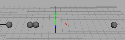

The next time you rewind the animation to frame 1, each marble’s translateX attribute receives a different random value. Maya might assign these values:
| Attribute | Value |
| marble1.tx | -3.972 |
| marble2.tx | 9.108 |
| marble3.tx | -7.244 |
| marble4.tx | -3.065 |
You might prefer the marbles’ translateX values to stay the same when you rewind, for instance, so you can composite the marbles correctly among a foggy backdrop.

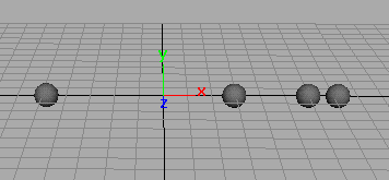

By setting the seed value to an arbitrary number, for instance, 10, the subsequent executions of the rand function return a repeating sequence of random numbers.
When you rewind the animation the first time, Maya might assign these values to the translateX attributes of the marbles:
| Attribute | Value |
| marble1.tx | 8.020 |
| marble2.tx | -2.973 |
| marble3.tx | -7.709 |
| marble4.tx | 0.741 |
Each time you rewind the animation thereafter, Maya assigns these same values to the translateX attributes of the marbles. The marbles don’t move.
