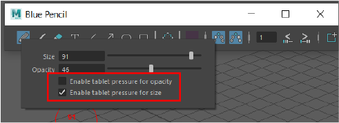

To use a tablet pressure settings with Blue Pencil
Right-click the Pencil
or the Brush
tool in the
Blue Pencil toolbar and activate the
Enable Tablet Pressure for Opacity and
Enable Tablet Pressure for Size options.
or the Brush
tool in the
Pencil tablet pressure settings
