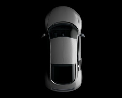

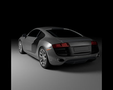

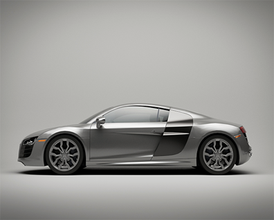

The Audi R8 car model (link at top of page) imported into the lighting rig scenes.
