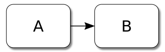

For example, in the simple graph,

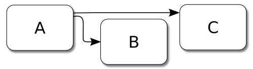

node A always evaluates before B. For a more complex graph,
although A is guaranteed to be evaluated before B and C, there are no guarantees about the exact timing of evaluation for B and C. Depending on the scheduling type of B and C, they could be evaluated simultaneously.
