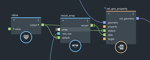

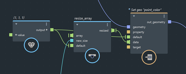

Show Nodes Names
Displays the node names instead of parameter values above the selected nodes.
Values appear in italics to distinguish them from names.
Show Node Types
Displays the types of nodes above the node names in the graph.
