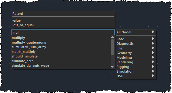

The Tab menu
To add a node using the Tab menu:
  1. Press the Tab key to open the Tab menu.
  2. Do any one of the following:
    • Start typing to see a list of matching nodes below, then use your pointer to select a node (or use the arrow keys to highlight a node then press Enter). You can type:
      • The first consecutive letters of a node's name up to any length.
      • Up to seven letters that form a concatenation of the beginnings of words in a node's name. For example, "gepopo" matches get_point_position, and "gpp" matches both get_point_position as well as get_particle_solver_properties and others. You can skip words but they must be in order; for example, scve matches scalar_to_vector2 and others.
      • Use a space to indicate that the next letter must be at the beginning of a subsequent word. For example, "c att", "c con", and "att c" all match clear_attribute_connections. After a space, the search find words that start with the next letter and contain the remaining characters, so you can find scale_to_vector3 by typing "s v3".
    • Browse and select a node from the namespace list on the right using your pointer or the arrow keys.
    • Select from the list of recently used nodes above.

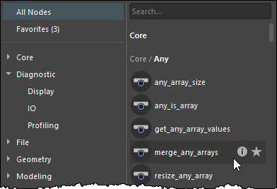

To open the Node Library, choose Windows > Node Library from the Bifrost Grpah Editor's main menu. By default, it opens docked on the left but you can drag its title bar to have it floating or to dock it on the right.
Node Library
You can:
  • Use the namespaces at left to browse the available nodes.
  • Add a single node to the graph by double-clicking or dragging it in.
  • Ctrl+click to toggle-select multiple nodes and then drag them all into the graph at once.
  • Type in the Search box to see the matching nodes. The search is the same as for the Tab menu:
    • The search results are filtered by the namespace selection at left. To see all matching nodes, click All Nodes at the top.
  • Hover the pointer over a node and then hover over its i icon to display a brief description. Also displayed is name of the JSON file, the name of the Bifrost library, and the library author (if available).
  • Click a node's star icon to add or remove it from your favorites.

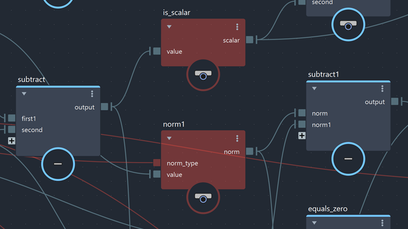

Unknown nodes
When you work with custom compounds, especially with different versions of multiple node libraries, it may turn out that a referenced compound uses unavailable nodes internally. This happens when the JSON files that define the internal compounds cannot be found among the currently available node libraries.
When there is a referenced compound that depends on unavailable nodes, the missing nodes are re-created as "unknown nodes". These appear as dark red nodes in the graph. The graph cannot work as before in this state, because the computations performed by these nodes are unkown.
However, the external connections and input values of the unknown nodes are preserved. This lets you see the graph as it existed before, and gives you a chance to fix or update the graph more easily.
A graph with unknown nodes
You can copy and paste unknown nodes, as well as modify and save scenes that contain them. You can also explode compounds that contain them, and remove unknown ports using the right-click menu. The graph will work properly once the proper node definitions are available.
