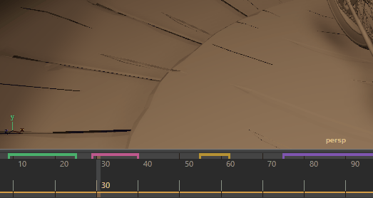

- Right-click the Time Slider Bookmark icon
in the
Range Slider.
- Right-click the Time Slider and expand Time Slider Bookmarks
- Select in the Animation menu set (F4)
- Create
- Opens the Create Bookmark dialog so you can add a bookmark to the selected frames. If no frames are selected, a single frame bookmark is created, or you can enter the bookmark range in the Start and End frame fields.
- Hotkey: Alt (Option) + T to open the Create Time Slider Bookmark window. Alt (Option) + Shift + T: Quick Create Bookmark (doesn't open the Create Time Slider Bookmark window.
