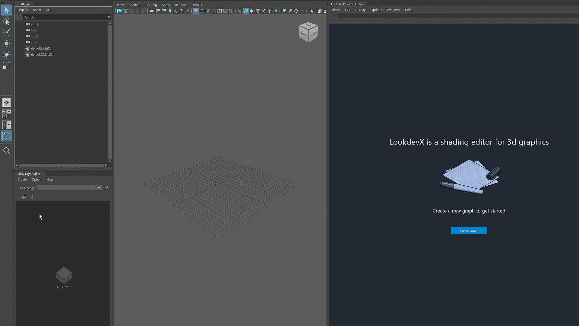

  • Ensure that LookdevX and USD for Maya are loaded in the Plug-in Manager (Windows > Settings/Preferences > Plug-in Manager)
  • Open USD Layer Editor (Windows > USD Layer Editor)
  • Open LookdevX Graph Editor (Windows > LookdevX Graph Editor)

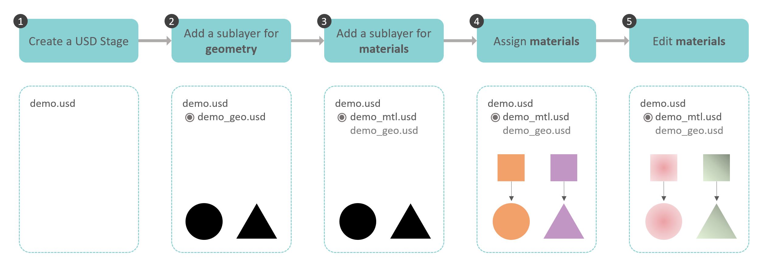

Basic workflow:
The following diagram describes a workflow for working with LookdevX using the USD data model.
diagram for USD workflow

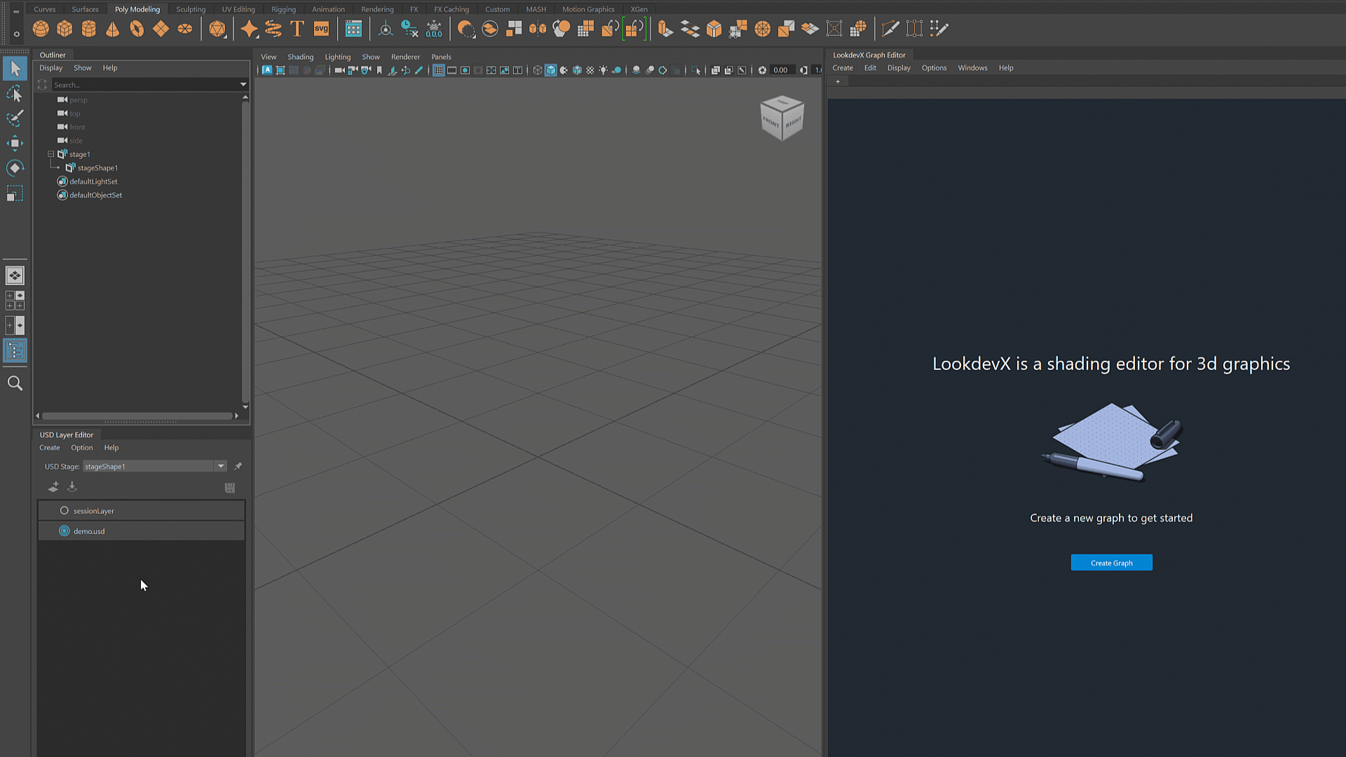

1. Create a USD Stage
To create a USD stage, select Create > Stage with New Layer.
gif for creating a USD stage

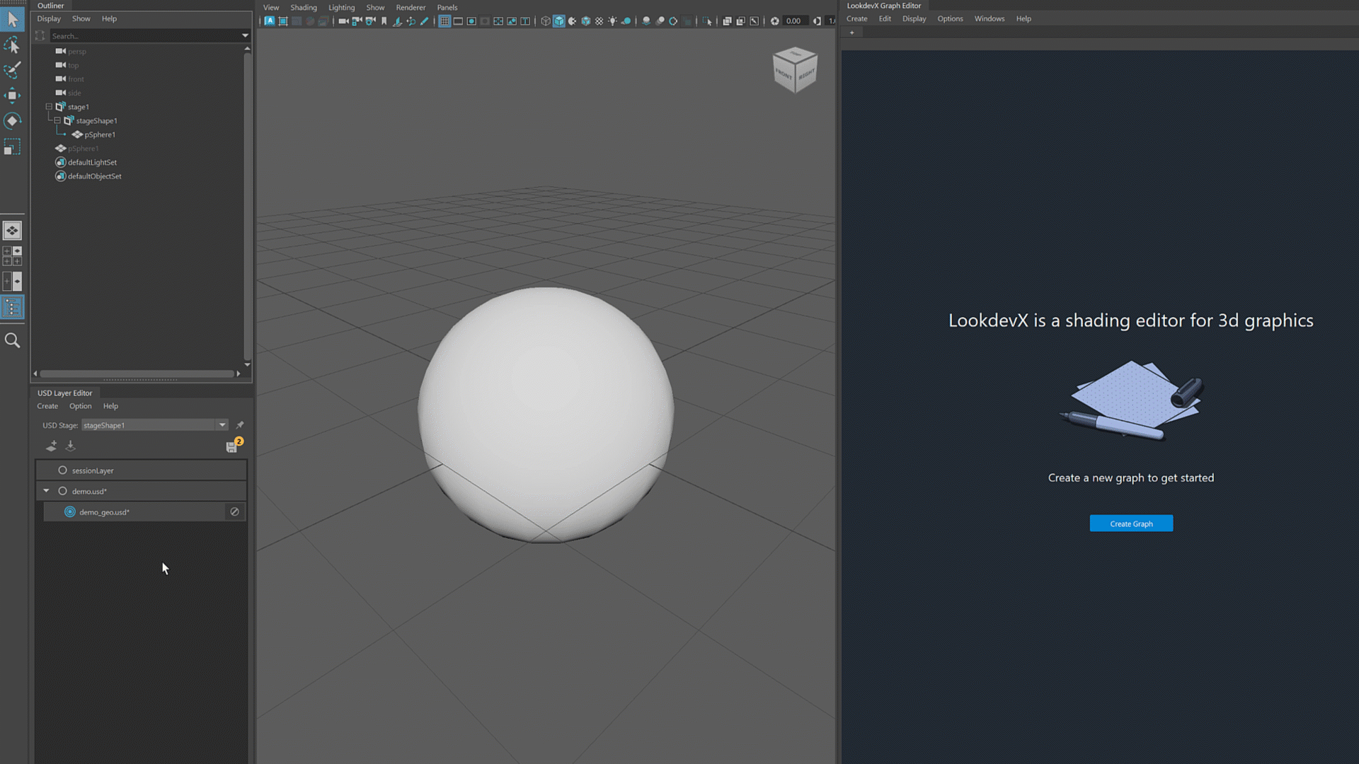

2. Add a sublayer for geometry
To add a sublayer, right click the layer and select Add Sublayer.
gif for adding a geometry sublayer

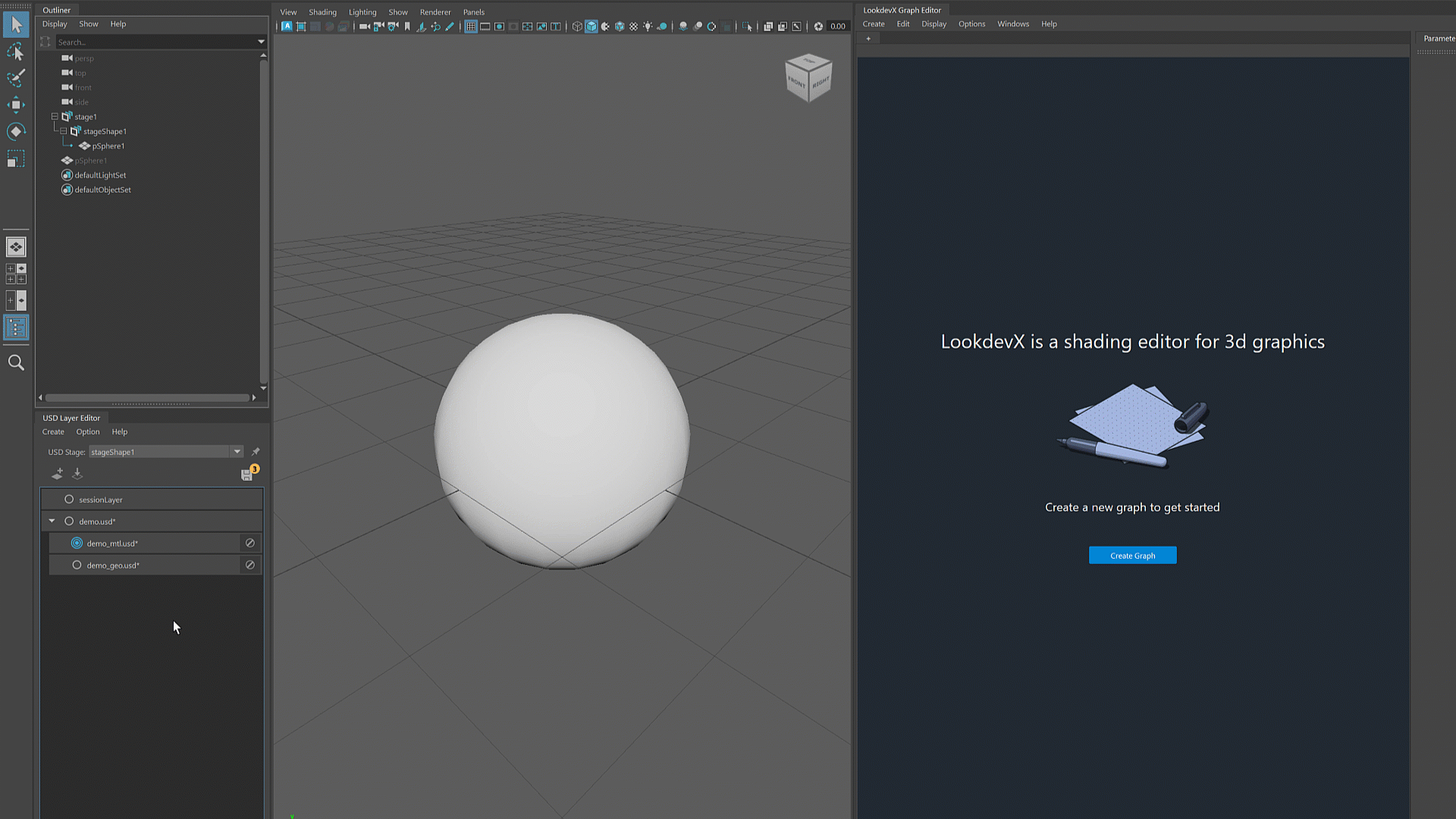

3. Add a sublayer for materials
Following the same procedure in step 2 to create a sublayer for materials.
gif for adding a material sublayer

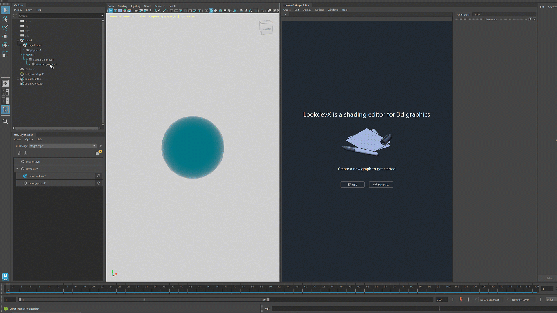

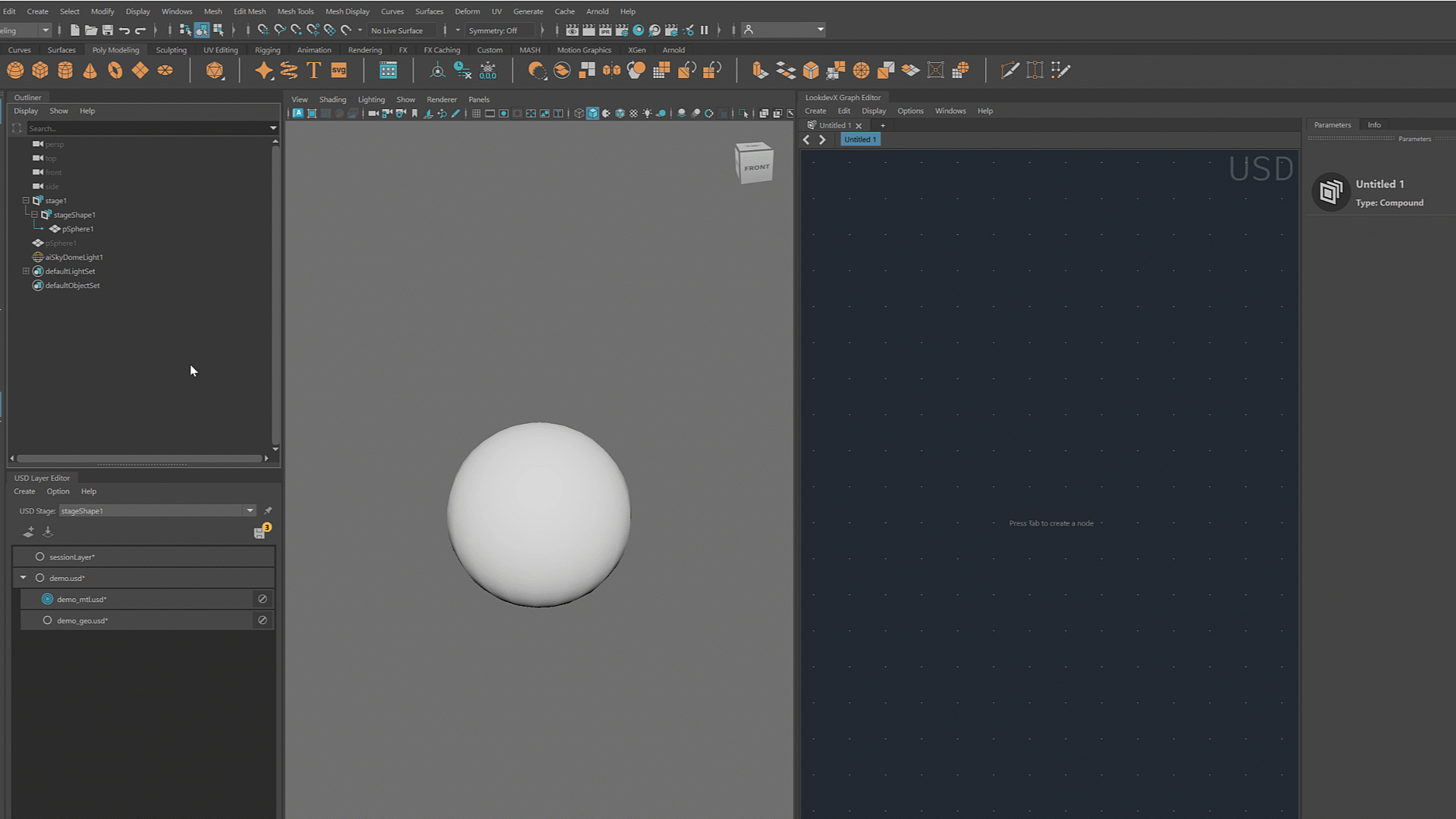

4. Assign materials
To assign new material to a geoemtry, right click the geometry in the Outliner and select Assign New Material.
With LookdevX, you can choose from these material formats: Arnold, MaterialX and USD Preview Surface.
Example 1: assign Arnold standard surface to the geometry
gif for assigning arnold material
Example 2: assign MaterialX standard surface to the geometry
gif for assigning materialX material

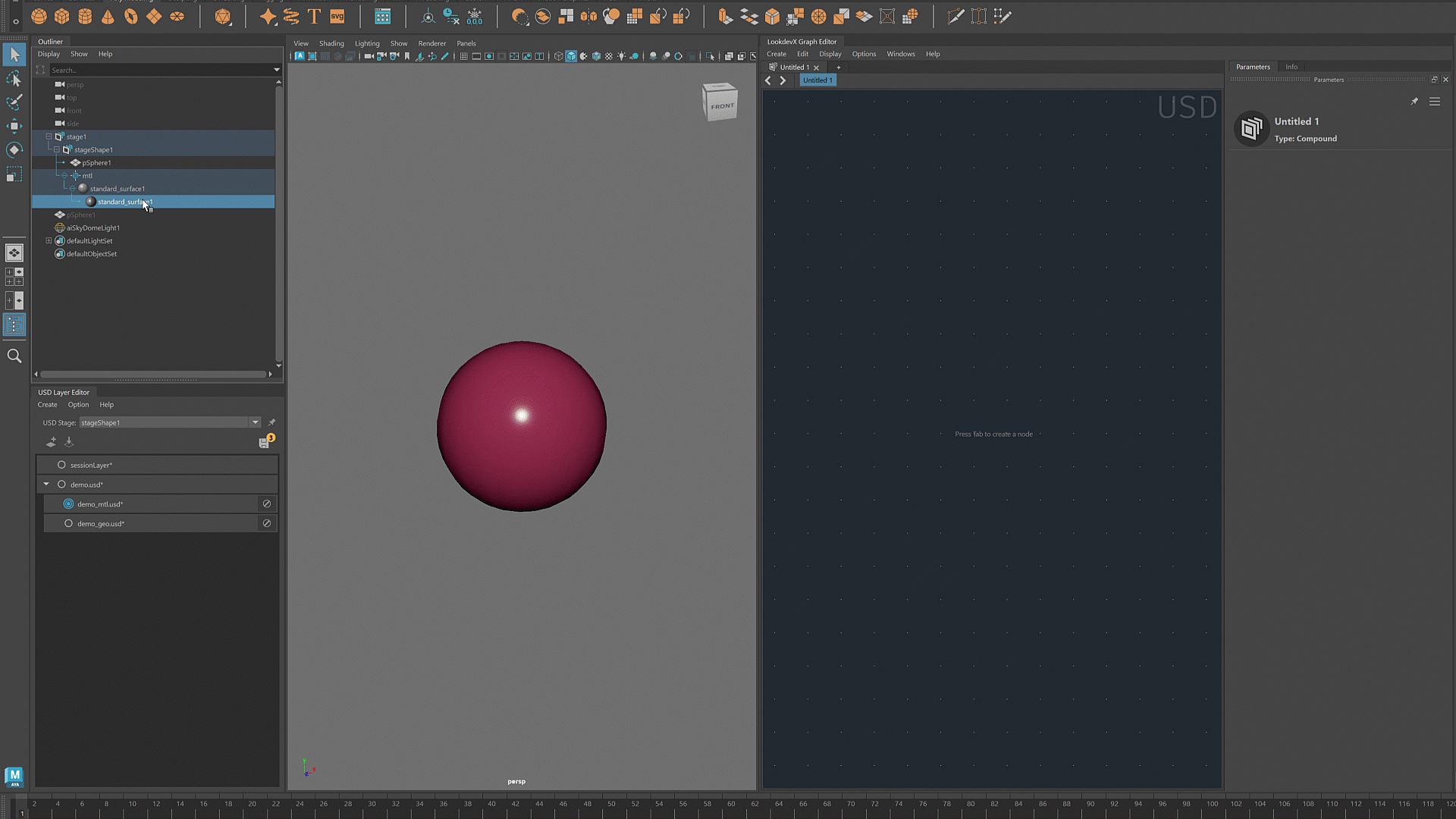

5. Edit materials in LookdevX
Example 1: edit Arnold materials
gif for editing material
Example 2: edit MaterialX materials
