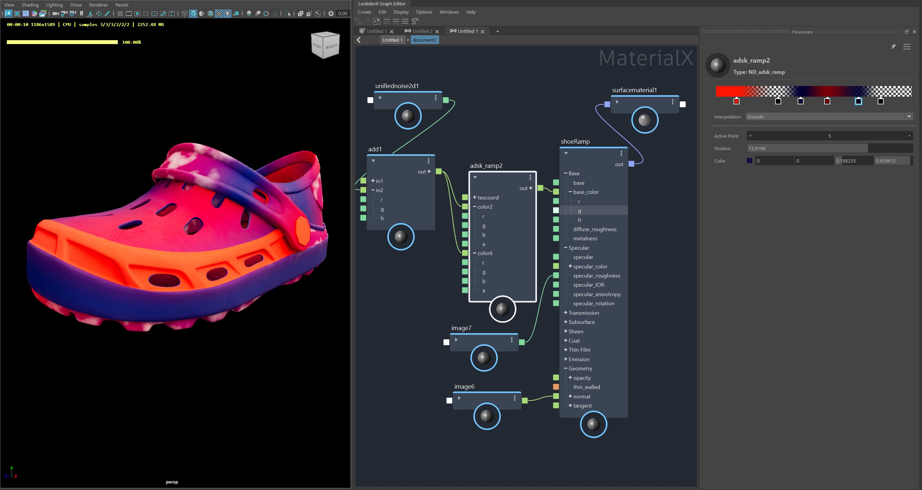

adsk_ramp node
The adsk_ramp node can be used to create gradients of colors, including textures and other nodes, to be used in your material graphs.
Creating an adsk_ramp node
Press tab then type "ramp" in the search field, choose adsk_ramp from the list. Alternatively, open the Node Library and search under Libraries, choose adsk_ramp.
Ramp Node Properties
Ramp Swatch
The Ramp Swatch is found at the top of the Property Editor and shows the colors in a gradient pattern read from left to right.
- To create a Control Point on the Ramp, hover the mouse over the Ramp Swatch, a transparent preview of the Control Point will appear to indicate where it will be created. Left click once on the Swatch to create the Control Point. The Control point can be moved by clicking and dragging the Control Point left and right. Up to 30 Control Points can be created.
- To change the color of a Control Point, double click the Control Point box and choose a color form the Color Picker that appears. Alternatively, click the controls in the Color section of the Parameter Editor.
- To delete a Control Point, right-click on the Control Point and choose Delete, or, click and drag the Control Point downwards away from the Ramp Swatch.
- To expose a Control Point as an input on the adsk_ramp Node, right-click on a Control Point and choose Expose as Input. A Control Point exposed as an input lets other nodes, such as Image nodes, be connected to the adsk_ramp node.
