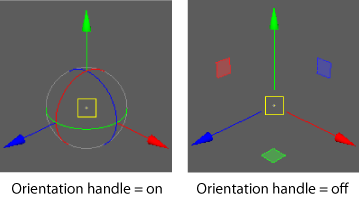

Pivot Manipulator
- Orientation handle
- Controls the visibility of the orientation handles. The orientation handles are turned on by default.
- Orientation handle size
- Sets the size of the orientation handles. The default size is 50.
