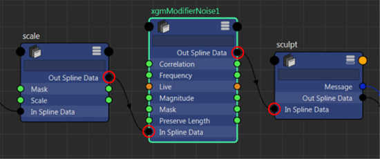

Add a modifier using the Node Editor
After you add a modifier, you can edit, delete, or disable it in the Node Editor like other Maya nodes.
- In the Node Editor, create a modifier node by pressing Tab and typing its name and press Enter.
All interactive grooming modifier nodes start with xgmModifier followed by its name, for example, xgmModifierNoise for the Noise modifier. For a list of modifiers and their node names, see Interactive grooming modifiers.
The modifier node appears in the Interactive Groom Editor using its node name.
- Depending on where you want to position the modifier in the stack do one of the following:
- Position the modifier node between two other interactive grooming modifier nodes and connect its In Spline Data and
Out Spline Data
ports to the respective ports of the adjacent nodes.
- To position the node at the bottom of the modifier stack so it gets computed first, connect its In Spline Data port to the Out Spline Data port of the description_base node.
- To position the node at the top of the modifier stack so it gets computed last, connect its Out Spline Data port to the Input Spline Data port of the descriptionShape node.
Out Spline Data
