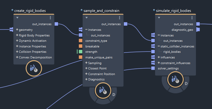

Constraints should be added to rigid bodies before they are connected to the simulate_rigid_bodies node, after create_rigid_bodies or set_rigid_properties.
Both sample_and_constrain and constrain_in_radius are convenient nodes that you can use to create constraints between multiple pairs of rigid bodies in a procedural manner. They have controls to filter the points to constrain based on the names assigned in the rigid body properties.

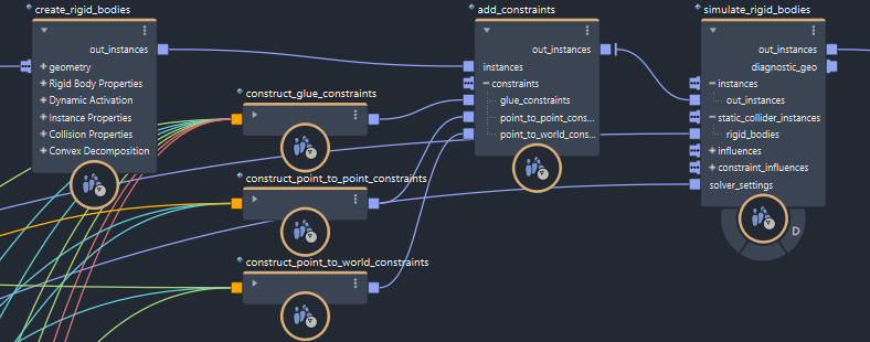

For more direct control, you can use any of the construct_*_constraints nodes to explicitly create constraints. Use add_constraints to add them to the instances before connecting to the simulate_rigid_bodies node.
