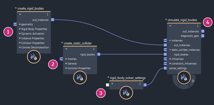

basic_rigid_body_graph
Add a basic_rigid_body_graph node, then right-click on it and select Explode.
Connect the meshes that you want to simulate into the
geometryport ofcreate_rigid_bodiesand set the properties as desired. If you want some meshes to have different properties (for example, to act as kinematic objects or to activate at a different time), then use additionalcreate_rigid_bodiesnodes and connect all their outputs to theinstancesport ofsimulate_rigid_bodies.For static colliders like floors and permanent walls, connect meshes to the
meshesport ofcreate_static_collider. Use solid meshes like cubes instead of planes. If you want different colliders to have different friction or other properties, use additionalcreate_static_collidernodes and connect all their outputs to thestatic_collider_instancesport ofsimulate_rigid_bodies.Use the
rigid_body_solver_settingsnode to adjust general settings like gravity and substepping.Do the following:
- Connect forces such as wind or drag and other general influences into the
influencesport ofsimulate_rigid_bodies. - Connect constraint influences such as
constraint_strength_influenceinto theconstraint_influencesport. - Connect the
out_instancesoutput port to anoutputnode at the top level of the graph, or to aterminalnode.

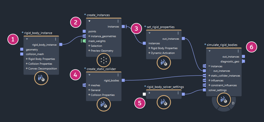

basic_rigid_body_instance_graph
Add a basic_rigid_body_instance_graph node, then right-click on it and select Explode.
Connect the mesh shapes that you want to instantiate into the
geometryport ofrigid_body_instanceand set the properties as desired. If you want some meshes to have different properties (for example, to act as kinematic objects or to activate at a different time), then use additionalrigid_body_instancenodes and connect all their outputs to theinstance_geometriesport ofcreate_instances.Connect the points object for the starting positions of the instances into the
pointsport ofcreate_instances, and select how to assign shapes to the point positions.Set properties as desired on the
set_rigid_propertiesnode.For static colliders like floors and permanent walls, connect meshes to the
