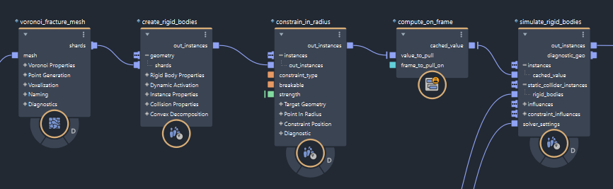

- Fracturing can be the most time-consuming part of a destruction simulation to set up. It's a good idea to use a
compute_on_framenode, after fracturing and other steps like constraints but before the actual simulation. This lets you adjust the fracturing on frame 0 without incurring any computational cost until stepping forward to frame 1.
