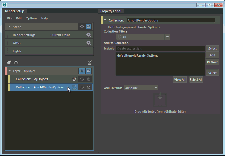

Example workflow: Override the Atmosphere attribute of the Arnold for Maya Render Settings
If you have added fog to your scene by connecting an aiFog to the Atmosphere attribute of the Arnold for Maya Render Settings, you can disable the fog for specific render layers by doing the following:
- Create a collection, and add to it the
defaultArnoldRenderOptions node.
Select All from the Collection Filters drop-down list to ensure that the node is not filtered out.
- Right-click the collection and select Create Connection Override.
- In the
Property Editor, enter
defaultArnoldRenderOptions.atmosphere and click
Create.
Leave the connection override unconnected to disable fog in your render layer.
