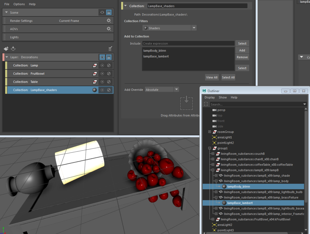

Create a connection override to override the texture assigned to the Transparency attribute of the shaders assigned to the lamp_body and lamp_brassFixture.
Although shaders are used as an example in this case, you can follow the same guidelines to override any attribute connection. Instead of adding your shaders to the collection, add the node for which you want to override to your collection.
- Right-click the layer and select Create Collection to create a collection LampBase_shaders.
- In the Property Editor, select Shaders from the Collection Filters drop-down list to include shader nodes in this collection.
- In the
Outliner, ensure that
Display > Assigned Materials is enabled. Expand lamp_body and lamp_brass_Fixture in the
Outliner to display their materials. Select these two materials and click
Add in the
Property Editor to add them to the collection.

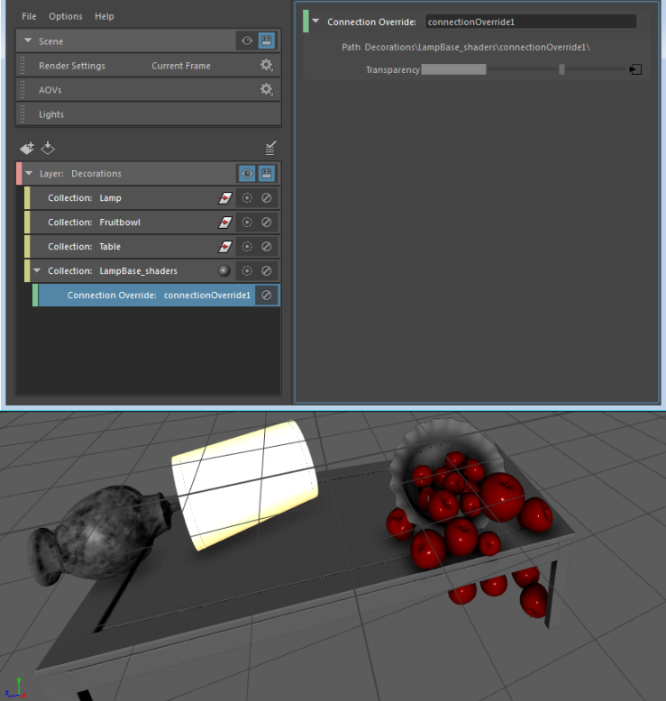

- Right-click the LampBase_shaders collection in the
Render Setup editor and select
Create Connection Override.
Drag and drop the Transparency attribute of any Maya shader from the Attribute Editor to the Property Editor, and map the override to any texture, for example, Fractal. The result is as follows.
Alternatively, you can enter transparency in the Type Attribute field of the Property Editor, and then map the override to a texture.
