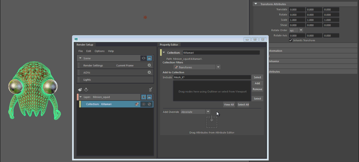

Create an absolute override
- Select the collection for which you want to create an override.
The Property Editor updates to display the attributes of the collection.
- In the collection
Property Editor, select
Absolute from the
Add Override drop-down list.
Tip: Select None from the drop-down list so that the drag and drop area does not appear in the Property Editor, leaving you with more space in the Property Editor to view your render setup node attributes.
Middle-mouse drag and drop the attribute that you want to override from the Attribute Editor to the Property Editor.
For example, to override the Translate attribute, middle-mouse drag and drop the Translate attribute from the transform node to the Property Editor.
An override is created and appears below the collection in the Render Setup editor.

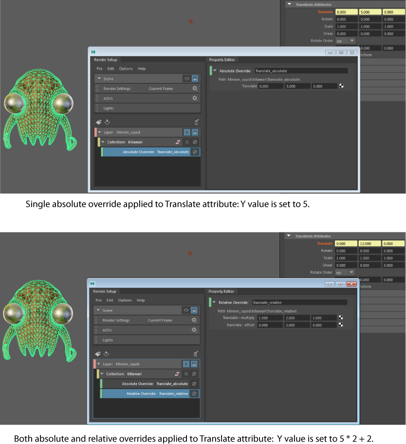

You can also combine both your absolute and relative overrides. In this example, an absolute override is applied to the Translate attribute where its Y value is set to 5. A relative override is then applied to the Translate attribute where the Y value is multiplied by 2 and offset by 2. As a result, the Y value of Translate is set to 5*2 + 2 = 12.

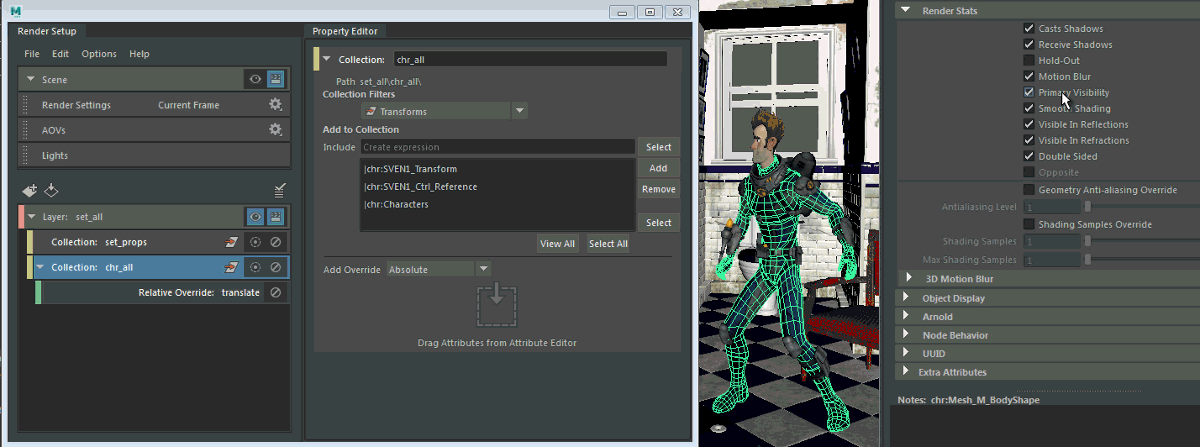

Follow the same workflow to create overrides on other nodes such as the shape node, or a shader node, and so forth. Note, however, that, by default, when you add nodes to a collection, only transform nodes are included. Therefore, if an override is created on an attribute that is not part of the transform node, Maya first creates a subcollection for the node type, then creates a corresponding override.
In this example, the character's transform nodes are included in the collection, and thus the character is visible in the layer. When the translate override is created, it is created below the chr_all collection. However, when an override is created for the Primary Visibility attribute, which is an attribute on the shape node, a sub-collection containing the shape nodes for chr_all is created, as well as a corresponding override.

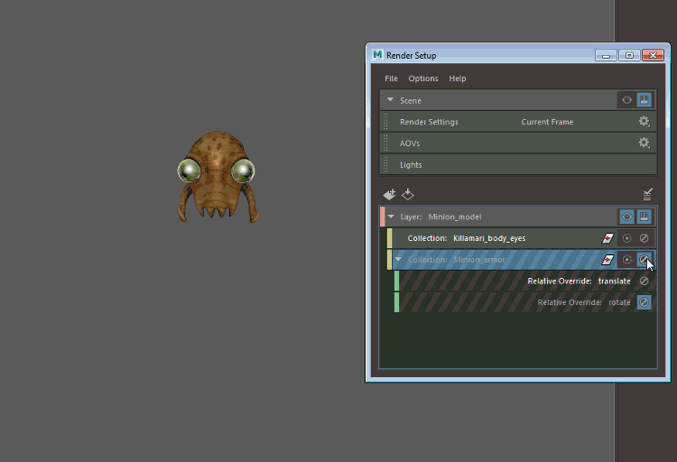

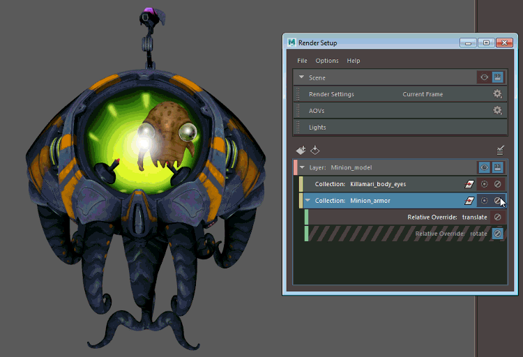

Disable an override
Disable an override so that it does not apply to your render but remains in the
Property Editor. To do this, click
on the override. Repeat this action to enable it again.
When you disable a collection, its corresponding overrides are also disabled. Overrides that were already disabled (before disabling a collection) retain their disabled state when the collection is re-enabled. In addition, they appear more dim in the
Render Setup editor compared to overrides that were originally enabled, and are denoted by a blue disabled
state.
In addition, you can enable or disable your overrides even when your collection is disabled. This state is retained when you re-enable your collection.

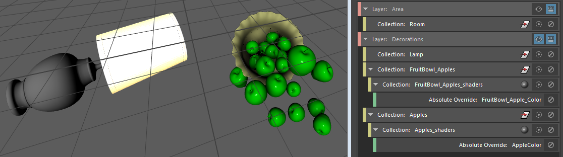

Order of application of overrides
Overrides are applied top-down. Therefore, if the same object appears in two collections, and both collections have an override for the same attribute, then it is the override further down in the list that determines the final value; likewise for two overrides in the same collection.
In this example, FruitBowl_Apples has a color override applied to set the color of both the fruit bowl and apples to yellow. Apples has a color override applied to set the color of the apples to green. The apples appear in both collections and a color override is applied in both cases. The override further down in the list (AppleColor) takes precedence and thus the apples appear green in the layer.

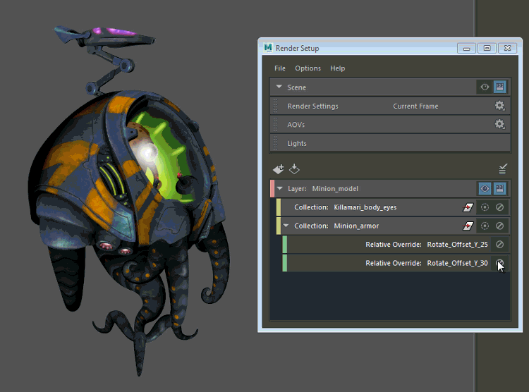

In the case of relative overrides for the same attribute, overrides are also applied top-down, but the results would be cumulative. In this example, a relative override has been applied to rotate the character by 25 degrees in the Y axis. Another relative override is created beneath the first that rotates the character by 30 degrees in the Y axis. The final result is that the character is rotated by 55 degrees in total.
