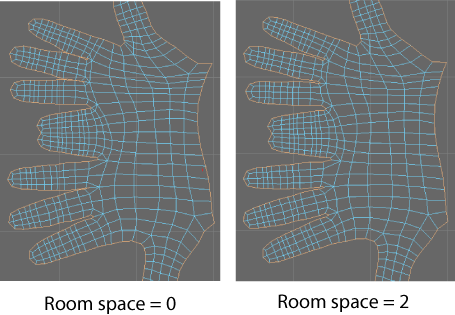

- Room space (Pixels)
- Specifies the distance between parts of the selected UV shell.
When Room space is greater than 0, it prevents textures from bleeding past the UV borders. Avoid increasing this value past its default (2 pixels), because it can slow down the unfold calculations and create distortion.
The following example shows the fingers of a hand. When Room space is set to 0, some of the fingers overlap. When Room space is set to 2, the space between the fingers increases.
Note: Prevent self border intersections must be turned on to see the effects of the Room Space option.
