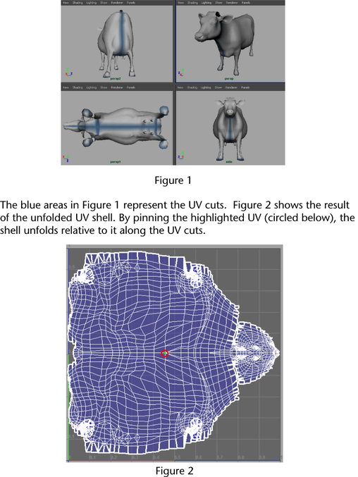

Consider the UVs you want to pin
Pinned UVs provide an anchor around which other UVs can be unfolded. If you don't pin at least one UV when unfolding a UV shell, the shell may unfold into a very tiny mesh or an undesirable shape. For symmetrical meshes, pinning UVs along the line of symmetry maintains the shape of the shell.

Tip: You can align UV edges that run down the axis of symmetry. For example, the line of UVs that run down the spine of a symmetrical four-legged animal, can be selected, aligned. and then pinned so they act as a benchmark for further unfold operations.
