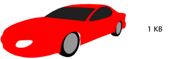

- Single Color
Fills each surface with one solid color based on the surface material color.
Single Color can produce nice cartoon-like results, especially when your model is composed of separate surfaces that each have a different colored material.
Note:The Single Color fill color is actually based on the surface material color and an ambient light (located at the camera) that is automatically created during rendering (and removed after rendering). Therefore, the fill color may not exactly match the surface material color. The fill color should not change during an animation.

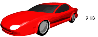

- Two Color
Fills each surface with two solid colors based on the surface material color and on scene lighting.
Two Color produces results that look slightly more 3D than Single Color, but also produces larger file sizes.
Tip:For geometric objects that consist of many flat planes (for example, a cube), Two Color may produce unnatural looking results (that is, each flat surface is filled with two solid colors). For such objects Average Color is usually more appropriate.

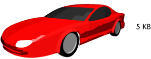

- Full Color
Fills each polygon on a surface with one solid color based on the surface material color and on scene lighting.
Full Color produces realistic 3D results, but also produces very large file sizes. (The greater the number of polygons in your model, the greater the file size.)
Tip:If you want to produce a high level of detail, and file size is not an issue, Mesh Gradient usually produces better results than Full Color.

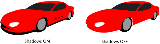

- Shadows (SWF and bitmap formats only)
Object shadows are rendered (based only on shadow-casting point lights in your scene). Shadows can greatly enhance the 3D effect. However, shadows also increase file size and significantly increase render time.
When Shadows is turned on, shadows are rendered for all objects. You cannot render shadows only on certain objects (for example, by turning off Casts Shadows or Receive Shadows for an object).
Shadows are only rendered if there is a shadow-casting point light in your scene (that is, a point light that has Use Depth Map Shadows or Use Ray Trace Shadows turned on).
Note:- You cannot set the shadow color.
- Shadows are not cast onto surfaces with transparent materials.

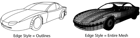

- Edge Style
When Edge Style is Outlines, surface edges and silhouettes are rendered as outlines. (Use Detail Edges to also render sharp polygon edges as outlines.)
When Edge Style is Entire Mesh, all polygon edges are rendered as outlines. Entire Mesh produces very large file sizes. (The greater the number of polygons in your model, the greater the file size.)

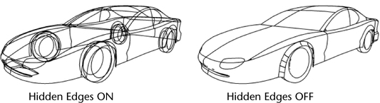

- Hidden Edges
Surface edges that are behind another surface are visible in the rendered image. (This may make certain objects look transparent or make models appear as wireframes.)
Hidden Edges increases rendered file size because of the extra vector information.
Tip:If you are rendering a model with many polygons, avoid turning on Hidden Edges and setting Edge Style to Entire Mesh; too many lines will likely appear in the rendered image.
