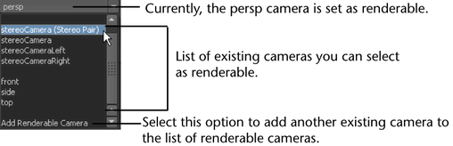

Renderable Cameras
- Renderable Cameras
Render a scene from one or more cameras. The default is to render from one camera.
If you are rendering the scene from one camera (only), select the camera from the drop-down list. By default, the perspShape camera is the renderable camera.
The drop-down list is divided into sections, separated by dashes:
The first section is the camera currently selected as renderable.
The second and third sections list existing cameras that you can select as renderable, for example, stereo cameras and the front and side cameras.
Note: If you select stereoCamera (Stereo Pair) from the list, both the left and right stereo cameras are rendered.The third section is the Add Renderable Camera option. If you want to add another existing camera to the list of renderable cameras, you can select Add Renderable Camera. When you select this option, a new Renderable Camera section appears. Select the additional renderable camera from which you want to render the scene from the drop-down list.
If you render from more than one camera, the rendered image output from each camera is stored in a different directory by default. For example, if you are rendering from camera1 and camera2, then the rendered images are stored respectively in camera1/scene.gif and camera2/scene.gif.
You can also override the default settings by using the File Name Prefix attribute. Right-click the File Name Prefix attribute and select Insert camera name <camera>. This way, all rendered images are saved to the same directory and identified with the camera name (for example, <camera>_<scene>.gif produces camera1_scene.gif and camera2_scene.gif). See File name prefix for more information.
