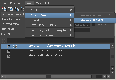

Proxy Menu
Add Proxy >
Adds a proxy reference to the currently selected file reference. When you select Proxy > Add Proxy > you can specify the file type to add and set the Proxy Tag Options within the Proxy Options window that appears.
Note:
The Proxy Options menu items are also available from the context sensitive menu in the Reference Editor. To display this menu, select a file reference and -click the item.
If a proxy reference does not exist for the file reference, a proxy set is created for the proxy references for that file reference. If a proxy reference exists, the new proxy becomes a member of the existing proxy set for that reference.
When a proxy reference is created, the listed file reference updates to display a icon to indicate that one or more proxy references exist for that reference.
General Options
File type
Select the file format you want to use as a default for the next time you add a proxy reference. If you have a project set up, when you open a scene, the browser points to the directory containing files of that type. On Windows and Mac OS X, it also sets the filter to display only files of the selected type.
Proxy Options
Shared Edits
Edits made to the proxy in the scene automatically update the proxy’s source file.
Set proxy tag to
Type the text string for the proxy tag you want applied to the proxy reference or select an existing tag from the list in the drop-down menu. When a proxy tag appears in gray in this list, it indicates that the tag is already in use for this specific file reference. The proxy tag appears in the Reference Editor.
After you create a proxy tag, it will become available for selection within the Proxy Tag Options drop-down menu in both the Proxy Options and Reference Options windows.
Proxy tags must be unique within a given proxy set. That is, a proxy tag will be available for a proxy set provided it is not already in use within the same proxy set. You can create your own tags and reuse them in different proxy sets.
File Type Specific Options
Depending on the File Type you select, various File Type Specific Options are displayed here. See Open Options.
Remove Proxy
Removes the proxy reference that is selected from the list of proxy tags that appears within the Remove Proxy submenu.
The list of available proxy references is displayed in the menu based on their proxy tags. The list of proxy tags is generated from all of the proxy tags currently in use within the proxy sets selected. When a proxy tag appears in gray, it indicates that it is currently loaded.
When a proxy reference is removed from a proxy set, and only a single file reference remains, the proxy set is removed and the reference returns to a normal reference state. In the Reference Editor, the icon is removed from the listed file reference, and the listed name of the file reference is updated.
Note:
It is not possible to remove a loaded proxy. To remove the currently loaded proxy you must first reload any other proxy reference from the list so that the proxy you want to remove becomes available within the list for removal.
Reload Proxy As
Loads the proxy reference that is selected from the list of proxy tags that appears within the Reload Proxy As submenu. The list of proxy tags is generated from all of the proxy tags currently in use for the proxy sets selected. When a proxy tag appears in gray, it indicates that it is currently loaded.
Reload Proxy As is used to switch between proxy references for a given file reference. The list of available proxy references is displayed in the menu based on their proxy tags. When a proxy tag appears in gray, it indicates that it is currently loaded.
Note:
A proxy for a specific proxy set is only reloaded when the selected proxy tag matches one of the available tags for that set. For example, if multiple proxy sets are selected and the high proxy tag is chosen for reload, only those proxy references that have the high tag will be reloaded. Any proxy set that does not include the high tag will remain unchanged.
