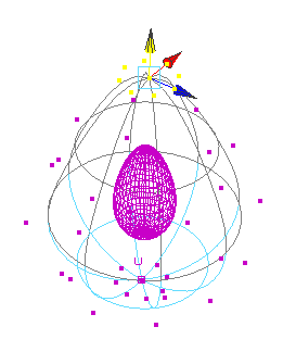

- Select some of the CVs of the low-res sphere and move them.
The high-res sphere deforms in response to the changes to the other sphere’s CVs.

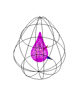

- Switch to object selection mode, keeping the low-res sphere selected.
In the Channel Box, note the sphere’s two new channels: Dropoff and Wrap Samples.
- Set Dropoff to 20.
The deformation becomes more pronounced.

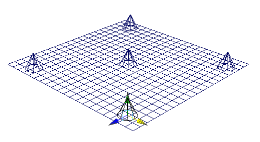

- Create a NURBS plane with all the default options, except set Width to 20, Length to 20, U Patches to 20, and V Patches to 20.
To create cones
- Create five NURBS cones with all default options. Arrange them on the plane as follows:
- Group all the cones together.

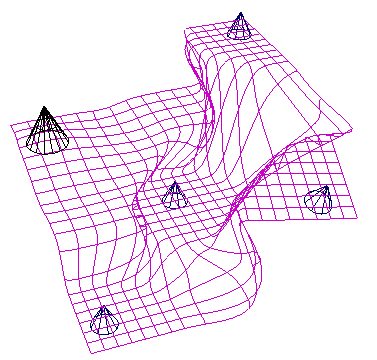

To deform plane by moving cones

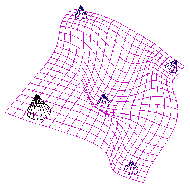

- Move, rotate, or scale the cones to deform the plane.
You can create a wide variety of deformation effects just by manipulating the cones.
To edit deformation effects
- Experiment with each cone’s Dropoff channel.
For more information on the Dropoff and Wrap Samples channels, see Editing NURBS wrap influence object channels.
- In the Channel Box, note that the wrap deformer node (wrap1) is listed in the OUTPUTS for the cones and in the INPUTS for the plane. Select the wrap deformer node. Experiment with wrap1’s Weight Threshold channel, which can provide sharper or smoother deformation effects.
