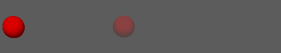

You can activate Ghosting on a clip to view the progression of a single animation clip. This lets you view the start and end positions of a selected animation clips on a track and is useful when matching poses or blocking animation.
For example, this image shows an animation clip that has been split in two of an animated sphere. The second half of the clip has been moved further along the track, creating a gap between the clips:
Note: Because Ghosting is activated for only the second clip, only the second clip has a
icon next to the clip name.
In this example, clip Ghosting
is activated only for the second clip, the half that shows the second part of the animation. The ghost of the second clip's start position displays while the first clip is played.
