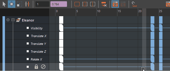

Select Tool
- Hotkey: Q
- Use the Select Tool
to select one or more keys in the View area. Drag to select a group of keys and
Shift-click to add nonconsecutive keys to the selection.
Use the Select Tool to select, move and scale, as well as copy, cut, and paste blank regions of time and regions of time that contain keys. See Edit keys using the Dope Sheet.
You can also use the Dope Sheet Manipulator in the Edit > Transformation Tools to move, scale, mute, add, or delete regions of time and keyframes so that the rest of your animation moves to accommodate the addition or removal.
For example, when a region of time and keys are cut, the rest of the time and keys in the animation shifts to fill in the gap created by the cut. When the time and keys are then pasted, the animation will shift to make room for the pasted time and keys.

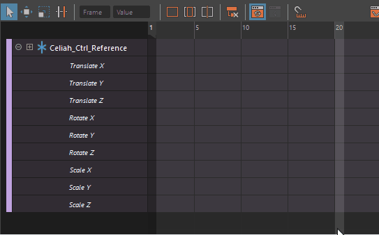

Frame all displayed keys
Centers the Dope Sheet View area on the selected keys.
Frame playback range
Frames the keys within the current Playback Range in the Dope Sheet View area.
Center the view about the current time
Centers the current time in the Dope Sheet View area.
Hierarchy below/none
Shows or hides the animation information of the child object for the selected parent object. If you have any parent-child relationships in your scene, activate Hierarchy below/none to display the child keys directly under the parent object.
You can also do this using the Hierarchy Below option available in the List menu.
Click Hierarchy Below to expand the object children keys

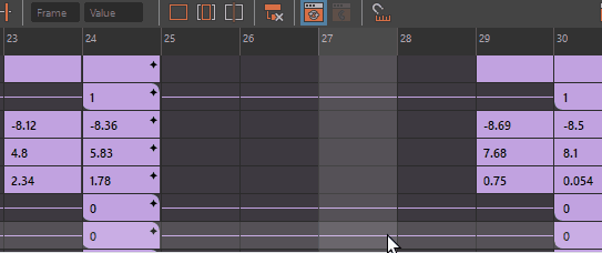

Time Snap
Moving a subframe key with Time Snap Off compared to On. When Time Snap is On, the star on the key showing it is on a subframe disappears.
- Activate or disables frame snapping. When this setting is On, it forces keys moved in the view area to the nearest whole, or non-fractional, frame number. You can see this if you move one or more keys marked as subframes with Time Snap active. The key loses the subframe marker, an * (asterisk) in the upper right corner of the key. There is also a Snap option in the Dope Sheet Edit menu that has Snap Keys options.
Note:
The Graph Editor also has a Time Snap option to move keys in the view area to the nearest integer time unit value, however, in the Dope Sheet Editor, Time Snap is Off by default to preserve subframes. See also Snap Keys.
