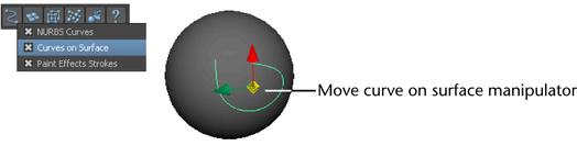

Curves on surface (along with their edit points) have a special Move manipulator. When you move a curve on surface, the manipulator constrains the curve on surface to the surface and allows movement across the surface in U and V.
